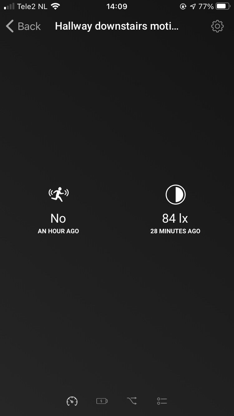

What I noticed in the last couple of days is still quite some motion detects that are ignored/missed, even on devices directly routed to Homey (and some through routers). I’ve done a ptp to let everything work out the routes, removed and re-added some devices again but to no solution; the motion detection still is hit and miss.
Am I the only one experiencing this and thus am I doing something different than others or?
Appreciate for your inputs.
FYI; the behavior inconsistency only seems to be with motion sensors, not the contact sensors, those are so far 100% accurate. What I find interesting is that sometimes the motion sensor will update the Lux value but not the motion. If I remember correct those two are linked and Lux is never updated without a motion trigger? Or has that behavior changed;
