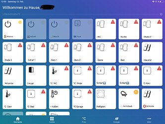

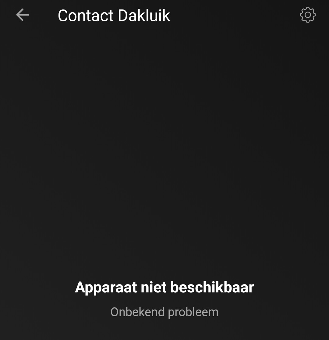

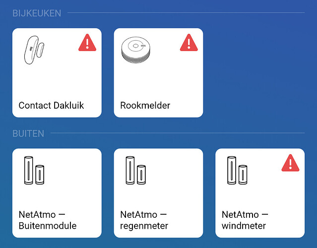

I updated to Homey 5.0.0 today. Everything works fine, except my Aqara devices:

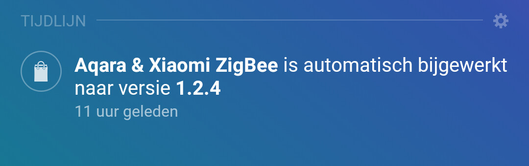

After update the Aqara app updated as well:
The app version should be OK:
I already tried to restart & PTP Homey and restarted the app.
Any idea how I could fix this?
Are there more people here with the same problem? I have the aquara motion sensors here at home, only now with homey firmware 5.0.0 I have the problem with some sensors that they do not switch my lighting on, but it does switch it off. So when I walk into the room it stays dark and after a while the lights go out automatically after I have turned them on with the wall switch. My flows always worked fine, but stopped after the update. I already added the sensors again and gave homey a ptp but that shouldn’t help
