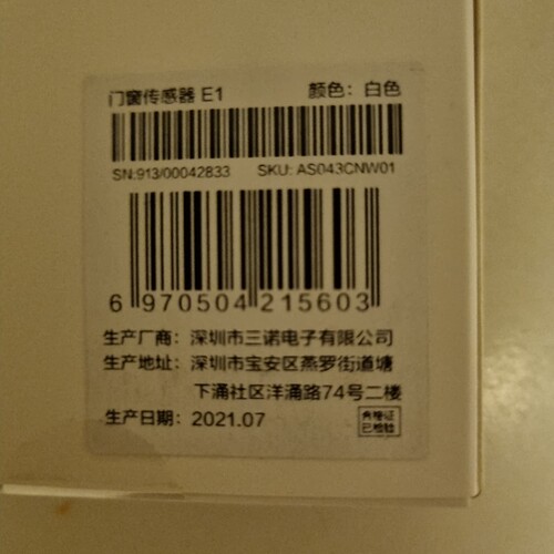

Can you check the modelID of your sensor with the supported ones, mentioned in this post?
(1st post on this page)
Aqara released new products recently that are not supported yet.
I will check the ModelID but where do i do that ?
Where can i see the ID ? I cant even add it to Homey.
Did you read my post? There’s a link in it… :slight_smile: ModelID can be found on the box of the devices or evt on the Ali page where you bought it.
Check this picture ?

These E1 sensors are not (yet?) supported.
Follow the “official” app tread here in the Community, as linked in my post above.
