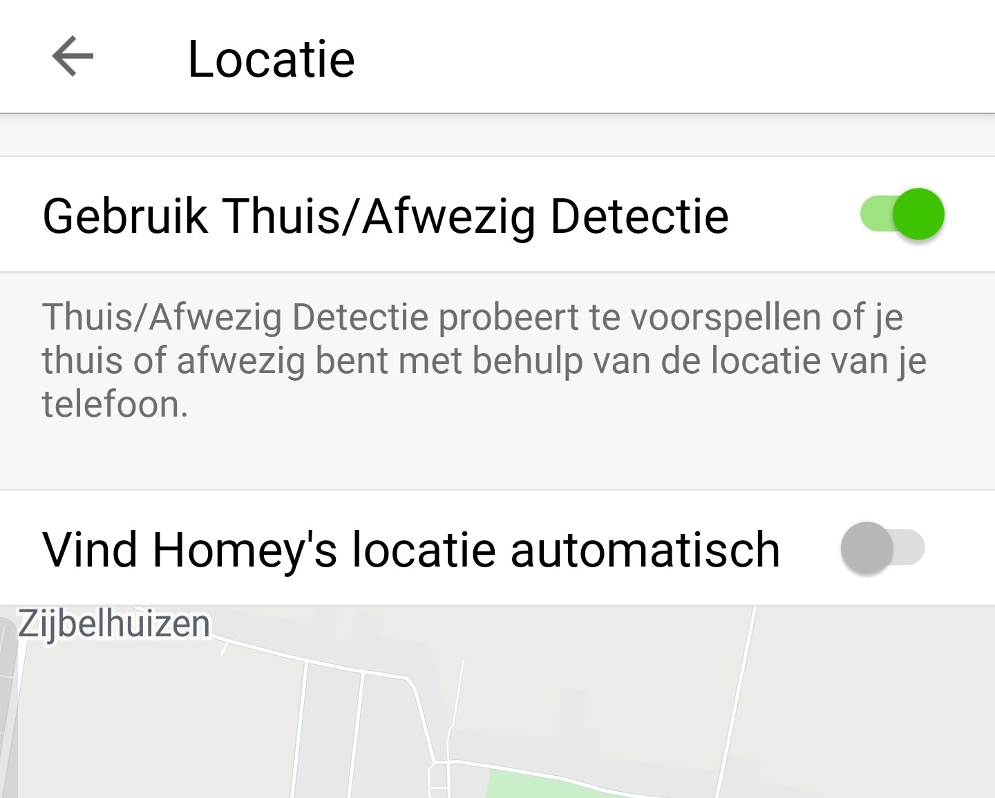

Just 2 b sure, do we all mean this setting? And set the pointer to your home location on the map?
And like @robertklep says, setting the pointer to f.i. New York and then back to your home location should solve the time issues
