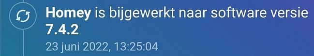

I installed v.7.4.2 two days ago on Homey Pro (previously running v7.4.2-rc.8).

Look at the trigger times and the update timestamp:
Local time was set to UTC…

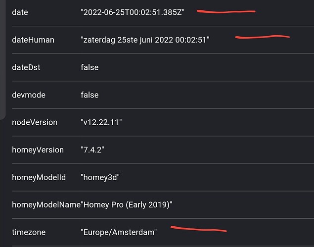

I went over to the developer page and it says UTC and human time are equal, now local time has become UTC time…?
The mobile app however, still displays the correct local time. I killed the app, cleared cache, restarted my cellphone, but no change…
