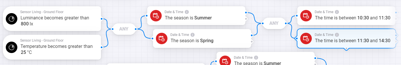

Dear community, i have created an advanced flow for my blinds.
Essentially the idea is to lower the blinds in my house by “following” the sun to keep the temperature inside the house manageable.
I have a fibaro smart sensor which works without any issue and i set the flow to start based on luminance and temperature levels (as per picture).
However, it is now 12.04pm, the sensor tells me that it is reading 914lx and the temp is 26 celsius (the sensor reported the luminance to homey 14 mins ago). Any reason why the flow related to time between 11.30 and 14.30 does not start?
Did i do anything wrong in the start of the flow?
Thanks
PS: when i test the flow all works fine. It is just that the flow does not auto trigger based on temp and luminance + time of the day!
Luminance probably was already above 800lux before your time window.
Luminance triggers only once, when it becomes greater than 800.
Hi @OH2TH correct…luminance was already above 800lux as well as temperature was already above 25.
Should i then create a logic that say if Luminance is above 800lux at that time of the day the card is YES and then if YES the flow is triggered?
Thanks a lot

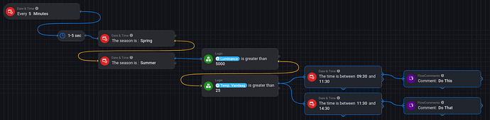

You would probably need to use the time trigger to:
  • trigger every N minutes
  • test for the lux and/or temp conditions
  • test for the time window
  • execute what you want
I wouldn’t trigger any flow more often than every 5 minutes.

While it is always a good practice to keep an eye on all triggers going on, I see no real issues in using a ‘every 5mins’ trigger, with a little variable delay (to prevent multiple triggers triggering flow conditions and -actions simultanuously).
Imho things can go really wild when one uses, like, every 1 or 2 or 3 sec triggers.
My flow suggestion would be:

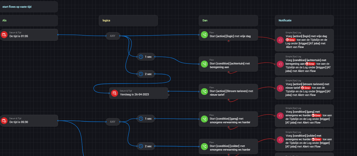

i use the flows like this, works like a charm.
the flows call the conditions, and the conditions call the actions… the system load has reduced this way, is my experience.

I think when you move the logic conditions like “Tapparelle EST Run is equal to no” right after the trigger delay, the rest of the flow stops and doesn’t get evaluated anylonger when these variables are Yes.
Although this is a bit ‘nitpick’ mode, it is a good practice to check which conditional cards stops a flow for the longest time every day in this case if the Tapparelle EST has run or not.
Like, the summer/spring cards only stops the rest of the flow in autumn/winter.
Oh, your ‘time is in between’ cards have the same values.
