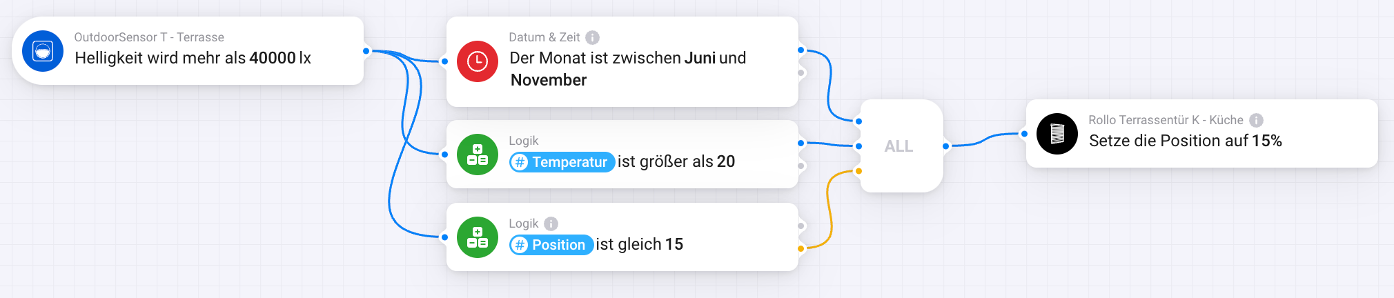

The flow could look something like this:
(This is the slightly more complicated variant)
You can also create two separate flows (easier variant):
So that the flow is not started unnecessarily although the roller blind is already in the position of 15%, you can also check the position of the roller blind:
And so on, and so on…
