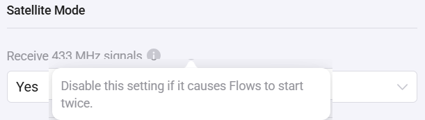

yep,
it is the advanced setting for the Homey Bridge that enable’s/disable’s the 433Mhz RF Receiver.
for KaKu receivers you can change the transmitter used from Homey Pro to one of the bridges.
So the setting itself is on the bridge?
And the setting is not visible if there is no bridge connected then?
It is a Global setting on the Bridge / Satellite to disable Receive 433 MHz
