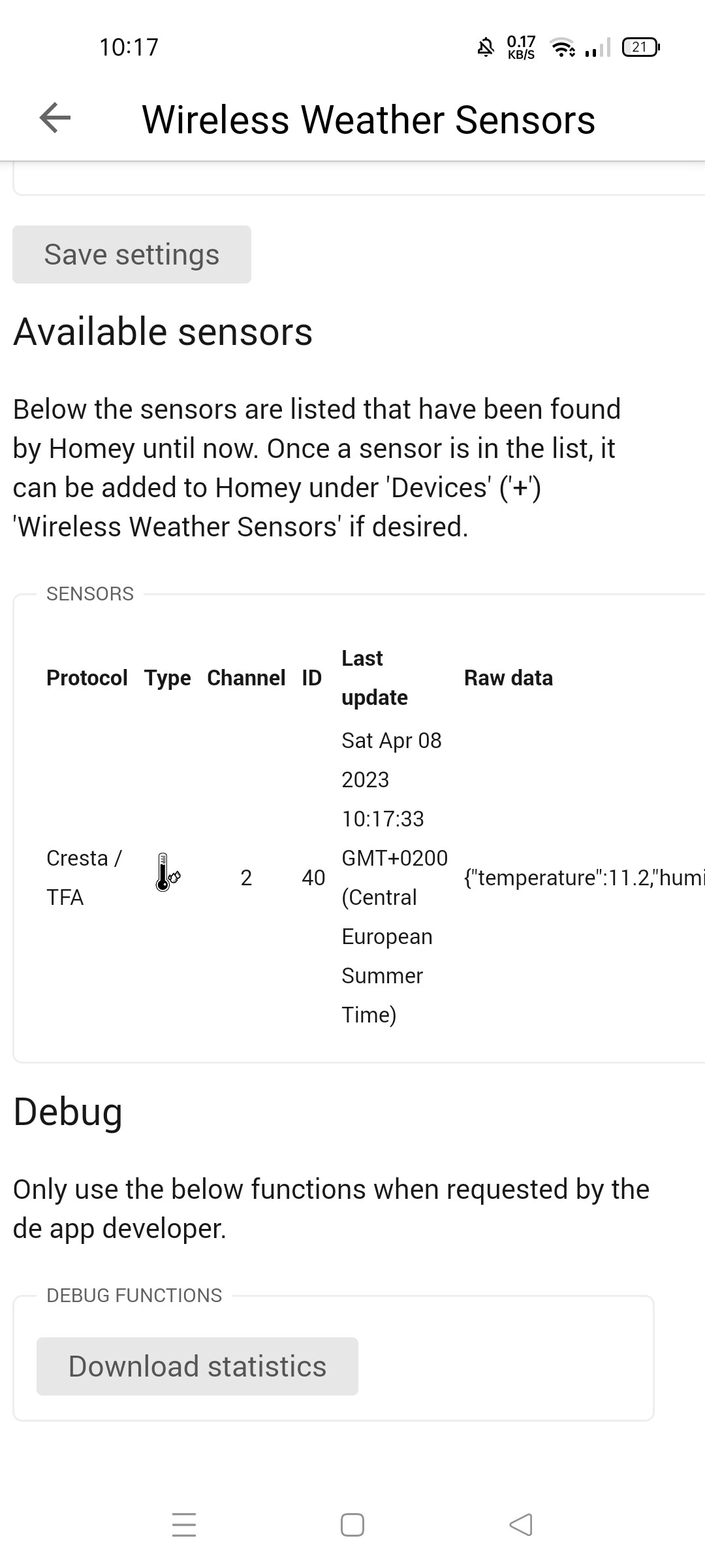

But however, I’m still a little bit desperated, because in the end, it makes no difference to my Homey Pro 2019: the wireless weather sensor app isn’t running anymore on my Homey (see the screenshot of my former post 433 failing - #19 by AlbertGaertner). I received all the updates provided of Athom. This is why my HP has firmware 8.1.3.
What could that mean? :thinking:

No hastle, no worries: :point_up_2: as I just tried to add my outdoor temperature and humidity sensor to Homey just right before, it worked properly. And that even before Easter! :grin:
You’re right! :+1:
Nevertheless, a restart of the app was necessary before. Than my sensor was recognized with its specific protocol.
Hopefully this very useful app will run without interruptions or sudden break downs in the future…
