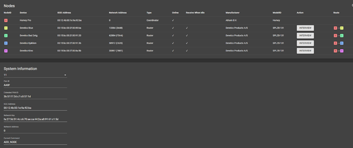

This is how it looks now, Wifi AP is channel 6 and 11.
more advices are welcome. Some frustrating now…

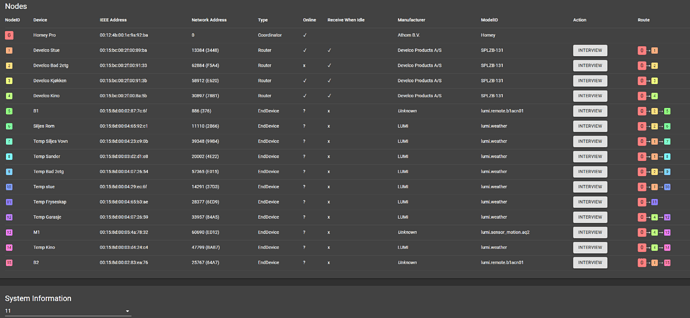

Well, then I found that several of the Auara Temp monitors is refusing to be added. When trying other I did get all, but 4 Aquaras wount add. They enter 3 blue blink state, but is not added. What can possible be reason to that ? I alway try to add them near the desired router.
The topology below is just as I want it, but have four sensors not adding …:
