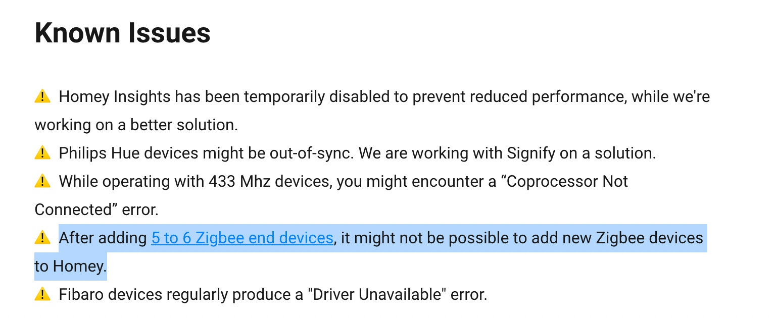

In total, I have about 15 Philips hue lights connected to Hue bridge (also zigbee) and 6 connected Aqara devices. No routers, just homey bridge+end devices. When trying to add the 7th device, homey app simply doesn’t recognize the devices, no error message, just a search prompt that doesn’t find the aqara-devices. It can’t find any new devices (temperature sensors/water leak sensors).

Thank you for the information, hopefully we will get a fix in the near future. Do you have any idea of when this could be fixed?

I doubt the issue gets fixed by adding a router device. I have no idea when/if it will get fixed, Athom doesn’t share timelines.
