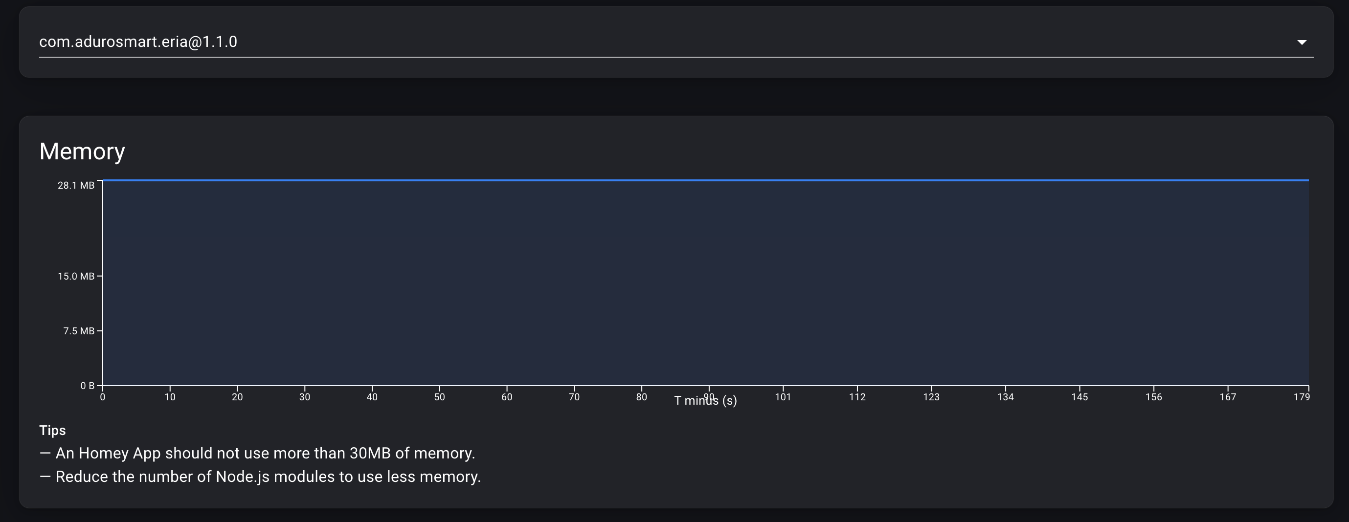

If I look here: Homey Developer Tools
And then for my own app, it says it’s using a consistent 28.1MB.
Is there any other spot where I can check the memory usage?

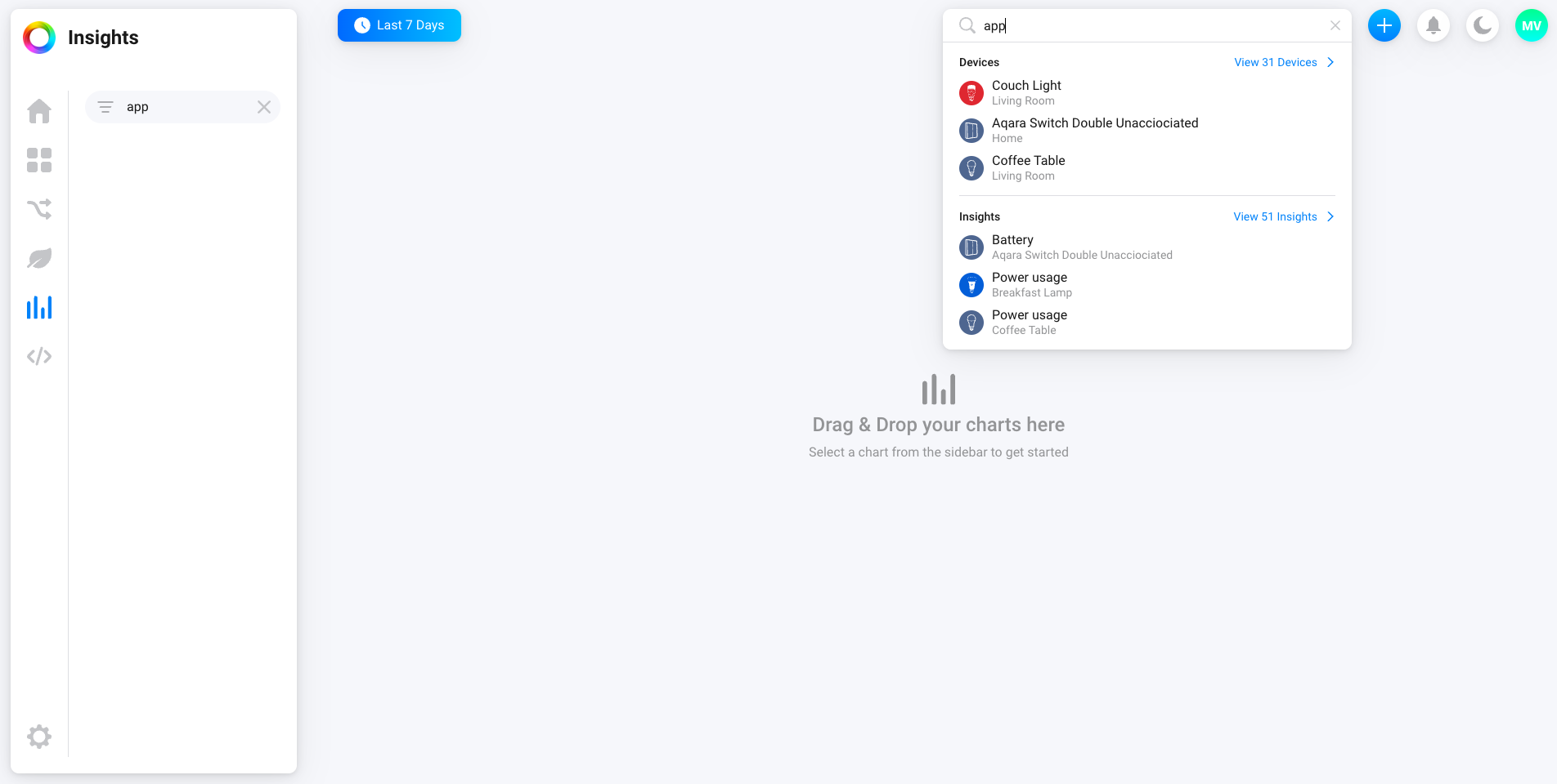

Yes, not sure if the value will differ though
Hit the graph icon on the left
Enter ‘app’ in searchfield
Scroll to app name
Not sure in what field, but it won’t show up in either:

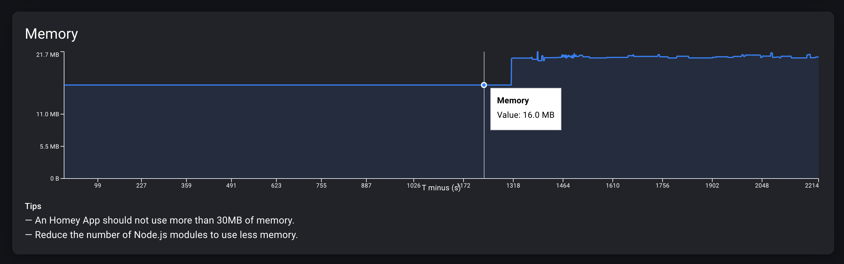

I have also attached my current memory usage, the strange thing is that it is completely stable after starting up the app for about 20 minutes or so, and then it suddenly spikes and afterwards it goes up and down tiny amounts:
