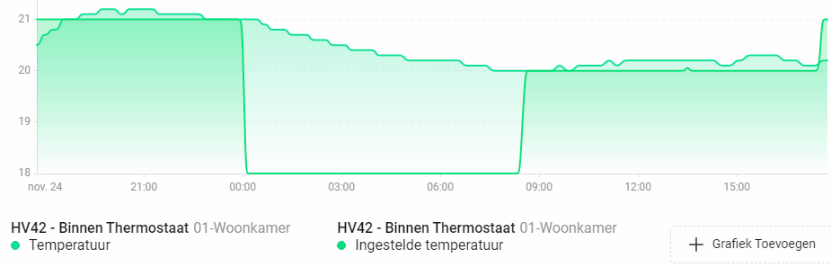

My Tado Thermostat shows different values:

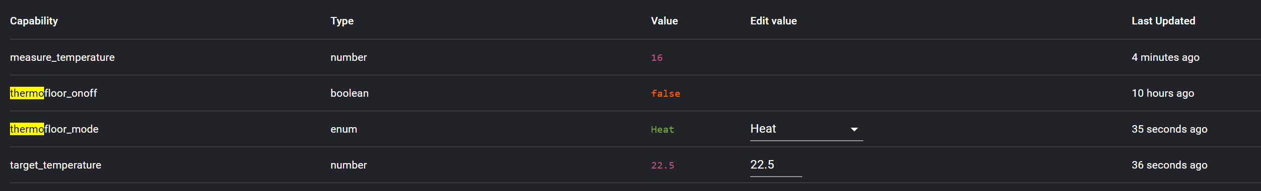

In the developer tools, it seems you can manually set the temperature or heating mode

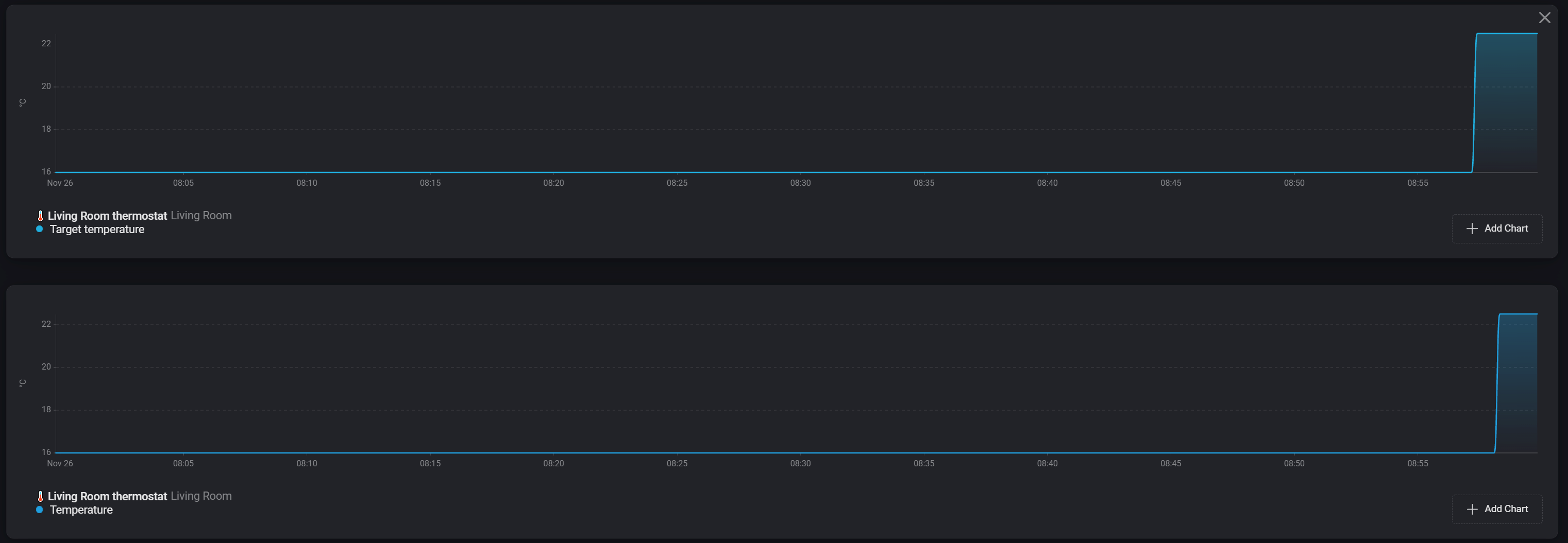

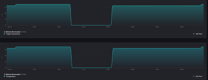

…but “Insights” immediately shows both set and target the same.

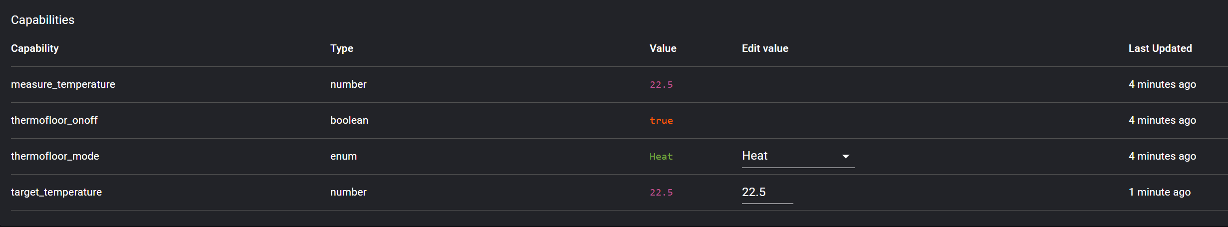

Then a minute or so later, in the developer page, the measured temperature is reported as matching the
target, which is obviously not right (it’s under floor heating under wooden floors so will take many hours for the change to measurable ay the wall thermostat.
I’m not sure whether that means the app is at fault or the athom code that reports the insight?
Because measure_temperature takes on the value of target_temperature in the capabilities table as well (not just in Insights), it sounds like either an app fault ór a device fault (where the device reports an incorrect measured temperature value). You can post an issue here: Issues · Heatit-Controls/no.ThermoFloor · GitHub
