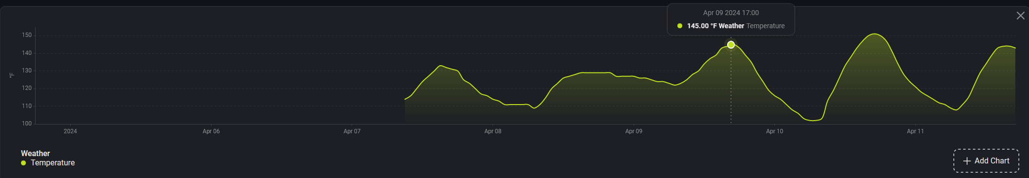

I’ve recently picked up Homey Pro and started checking out the insights. One of the cooler features shown was to overlay the home sensors against the outside temperature. When showing the built in Temperature data though I get a wildly off value (attached). The home screen value is correct with the correct weather forcast (Showing 143 F, when it’s actually 58 F for example). I’m assuming there is some inverse calculation being done for the C to F conversation here, but I’m unsure if there is something I can do to correct Homey. I have changed my location a couple times (Settings → Location → Drag Pin) to see if it would correct itself, but that doesn’t seem to work. Either way it looks to be a bug for Fahrenheit temps.
You should report this issue to Athom: https://support.homey.app/hc/en-us/articles/360015784034-Submitting-a-support-request
