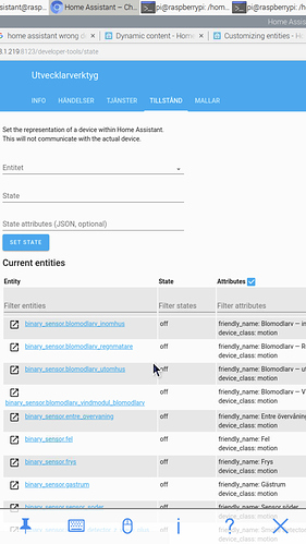

After Homey integration into Homeassistant my temp sensors is presented as binary sensors and all marked as ready insted of showing the temperature value. It wont help to delete and reinstall the Homey.
Any ideas what’s wrong or if its possible to change identiy type in Homeassistant?

And here are mine:
All my temp sensors has device-class motion and nothing else.
What’s the brand (and model) are your temperature sensors? The MQTT Hub app assumes that devices that have a alarm_motion or alarm_tamper capability are of device class “motion”, and I think that this might be the case in your situation.

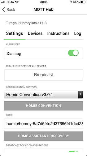

Thanks a lot for your tips and ideas.
Finally I tried to restart the Broadcast button and then my sensors is presented correctly.
