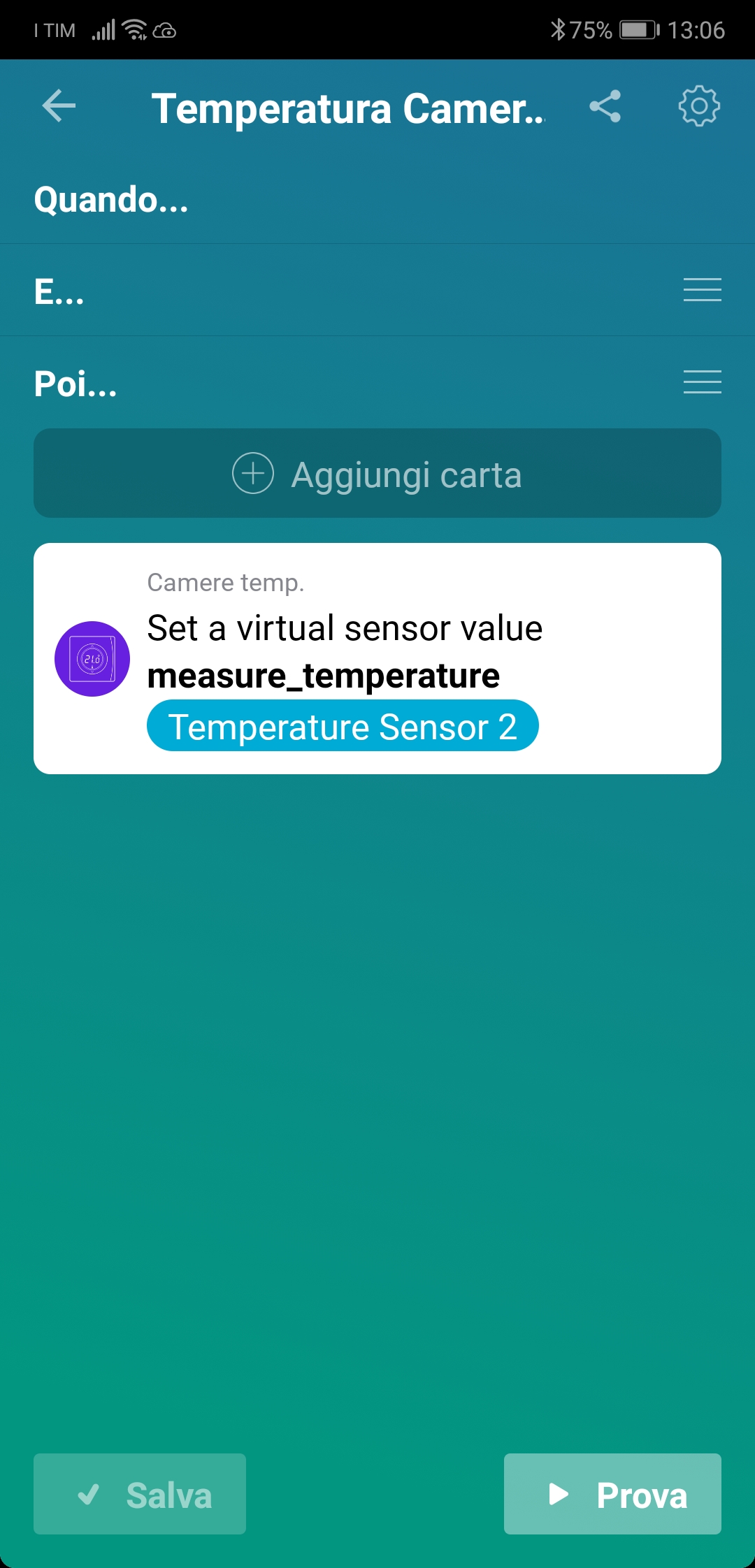

I did this way:
Download Virtual Device app
Make a new device Sensor with Temperature capabilities
Make a flow that every 120 seconds does the following
Camere temp is the virtual temp sensor created and Temperature Sensor 2 is the BINARY Temp sensor value
So that the new virtual Temperature Sensor gets the Binary temp sensor value.
That’s works.

I have started the flow with when the temp changes but method also great
Thanks again
With that setup I had probl ms due to too many times the flow was started and Homey blocked it after a while… But try.
