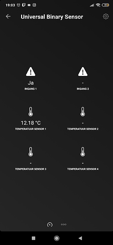

I have been trying to read the temperature from my Universal Binary Sensor connected to a temperature sensor. I get the output in the homey app as a temperature, but I am not able to use this in flows. For example sending a push notification every few hours to my phone with the temperature in it.
Any help on how I can do this?
If: All x hour (Date & Time)
Then: Mobil -> Send Push-Notification -> Your Message „The Temperatur is: Tag“
Tag = Tag means the little grey label on the right sight. Click on this label and search for the Binary Sensor and choose temperature.
