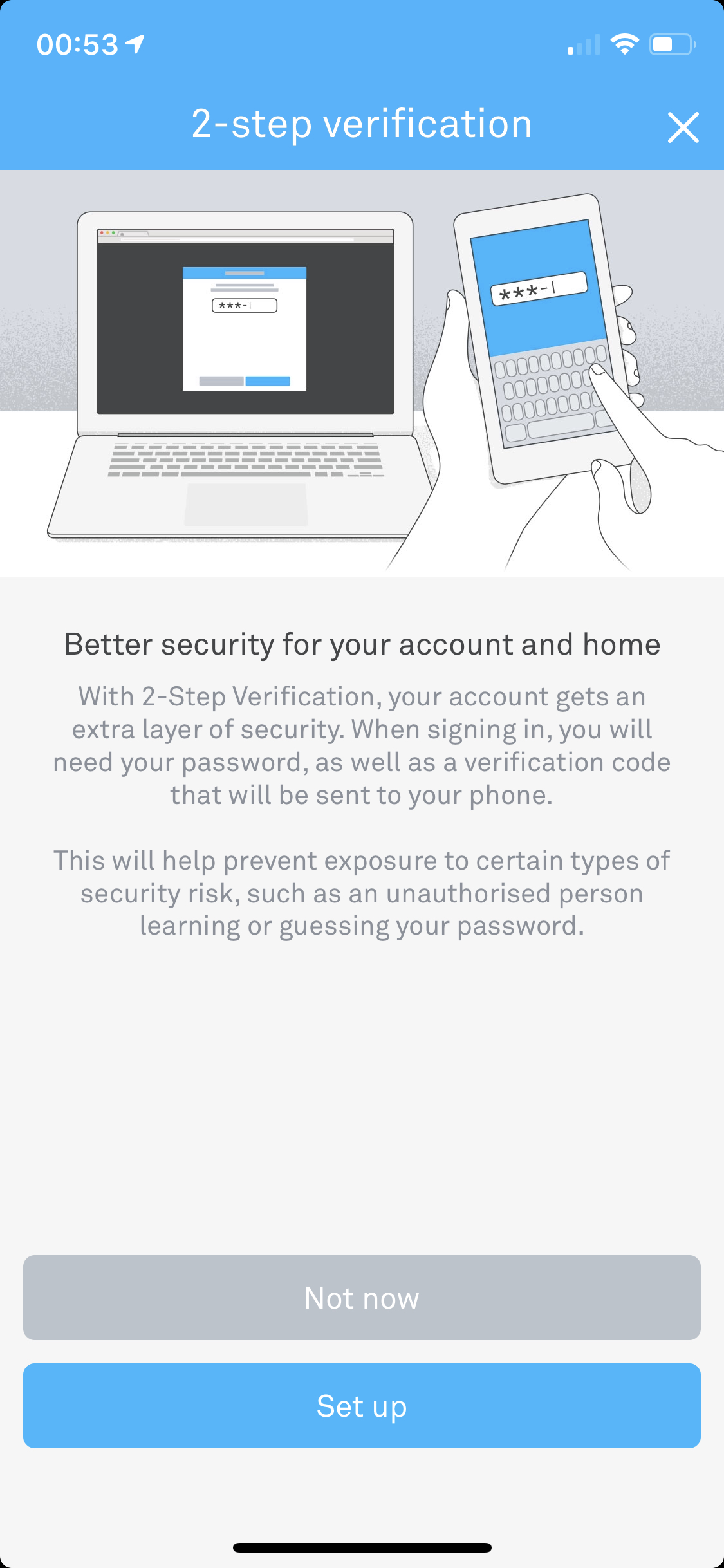

And you also didn’t click the button “I understand” instead of “not now” when you opened the official Nest mobile app?
It is a really tricky one that you can click really easily when you don’t read everything, haven’t been able to take a screenshot of the message (at the bottom of the screen) as it hasn’t reappeared yet for me, but have seen it twice now.
It isn’t fully the same reason, it is still using the “works with nest”, but not the default authentication anymore and thus your devices stop working.
I don’t recall the “I understand” button now.
When I run the Nest iOS app i still get asked about the 2 step verification.
