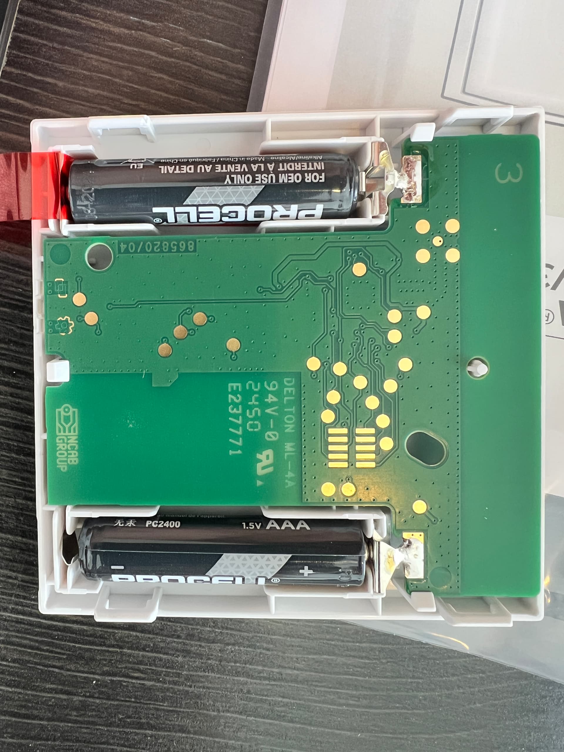

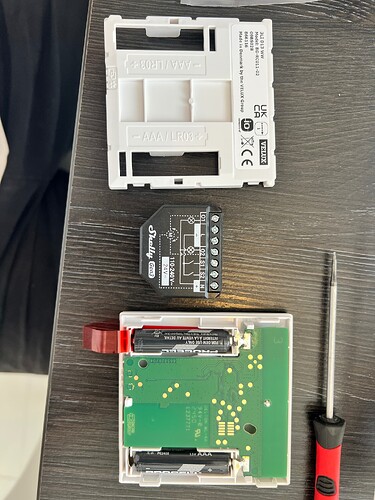

I’ve read through the entire thread and I’m in a similar situation. I’d like to control a Velux SML electric shutter (24V) via Homey.
I’m not afraid of a bit of soldering, but I’m not entirely sure what goes where.
I’d like to control it using a Shelly PM 2 relay in shutter mode.
Where exactly should I solder or connect the wires?
Am I right in thinking this is doable?
Thanks a lot for any help!
You need a relaymodule with dry contacts, that means contacts that are not connected to one of the power connectors. The point where to solder on, you have to find by measuring what points are connected to the keys that you want to simulate.
