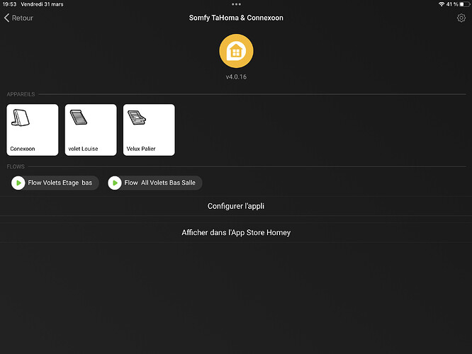

Hello Adrian, thanks for your apps👍!
I just bought a conexoon box.
I have paired Velux IO window and store, but I can’t find my interior’s Venetian blinds device in the list
Any idea?
Thank you!

So, the devices you have should appear as the following in Homey: “Exterior Venetian Blinds (io)”, “Velux roof window (io)” and “Velux roller shutter(io)”,
Thank you for your rapid answer,”, “Velux roof window (io)” and “Velux roller shutter(io)”, works perfectly, but Exterior Venetian Blinds (io) is not detected🤗
What is the name of the missing device, as it is shown in the Tahoma Mobile App?
Also, could you open the Configure App page, select the Device Log tab, click on Get Log and then Send Log. That way I get just the required device info and not all the other clutter so it is easier to find.
Done.
The missing device should be .interiors Venetian shutter IO’ but in the app there is only exterior Venetian blinds🤗.
I tried with all iO’s devices but no success…
Could it be because this blind is powered by the velux window on which it is installed?
But it works with a velux multi remote klr 100 ( as the other devices)
Thank you for your prompt support ![]()
I have one log in today with devices called “orientation lamelles store”, “Velux Palier”, and “volet Louise”, so is that from you?
I have published a test version so the orientation lamelles store should be found under Venetian Blind.
Just go to the store and add test to the URL to install it.
Hey Adrian,
Many thanks, It works , my venitian store is now paired, I can open and close it and also control lamelle’ss orientation!
thank you !
