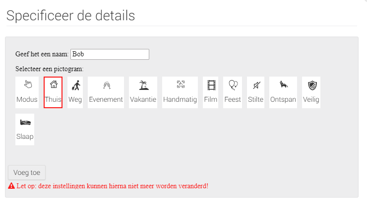

You can use “Virtual Devices”-app in combination with “Homekit”-app to control Apple Homekit devices and let the devices report back to Homey.

Yes - i’m using it.
I have a Homekit-managed camera;
I’ve installed “HomeyKit”-app and “Virtual Devices”-app and installed a Mode-Virtual-Device - called “Movement”.
HomeyKit presents the device virtual-device-“Movement” to Homekit and it shows up in my mobile Home-app.
In the mobile Home-app i’ve made an automation that whenever my camera detects movement it turn-on the “Movement”-virtual-device.
In a Homey-flow i turn on a lamp whenever the “Movement”-virtual-device is turned on.
Works perfect :slight_smile:
