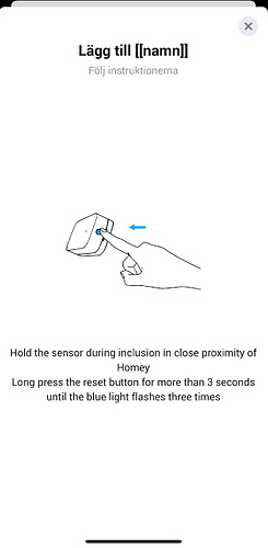

  1. Whatever I try to add, the name can’t be changed it just says “add to [name]”.

When adding the product (under pairing mode) the name can’t be changed (is that normal?)
No matter were I click I can’t edit the name (which I’m certain I’ve could before?)
It works the same from the MacOS-app and on the android. See attachement (swedish language)
I guess this is just a little insignificant bug in the app code. It normally says “Add Door and Window Sensor”. And the name of the device, in this case “Door and Window Sensor”, is filled in automatically. So maybe just the Swedish translation is missing.
The name of the device can’t be changed while the pairing process, just after the device was paired successfully with Homey.
