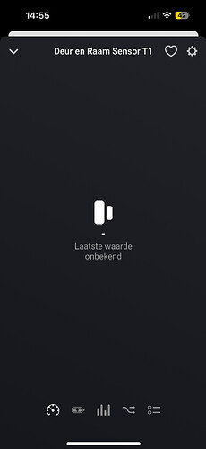

for me its not working (T1 door sensor)… maybe device is broken but it doesnt show any contact alarm. Device was added, recognized… but not working :frowning:

I tried the test version of the app (version 1.7.5) and still isn’t working for me. The device connects quickly but as an unknown Zigbee device. From which i can’t read the sensor info.
Does anyone have any other suggestions? version 1.7.7 also does not work for the door sensor. The current test version (1.8)cannot be installed. (incompatible_app_version)

I have the same issue over here. After updating everthing finally got the t1 in my app. But after I the device it doesnt response on the contact (alarm). I bought 2 devices and both have the same problem.
Do you or anyone else have a solution?
Looks like a bug, when several T1 contact sensors don’t send contact alarms…
