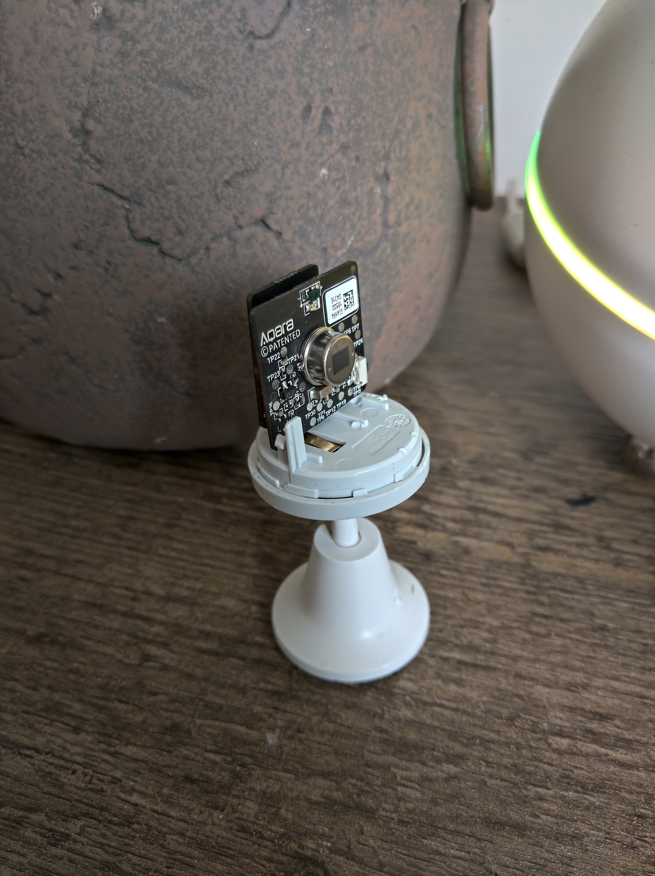

Okay I’m about to give the Zigbee network a total reset but cause I’m running out things to try. As a last test I tried to add my partially-eaten-by-dog-human body sensor and it added perfectly…

Just curious,
is this sensor:
a) partially eaten by both a dog and a human
b) partially eaten by a dog-human (in which case: what is a dog-human?)
c) built to detect human bodies that have been partially eaten by a dog?
d) or is it simply a human body sensor, which has been partially eaten by a dog?
Just wondering, since I would love to see an actual dog-human!
