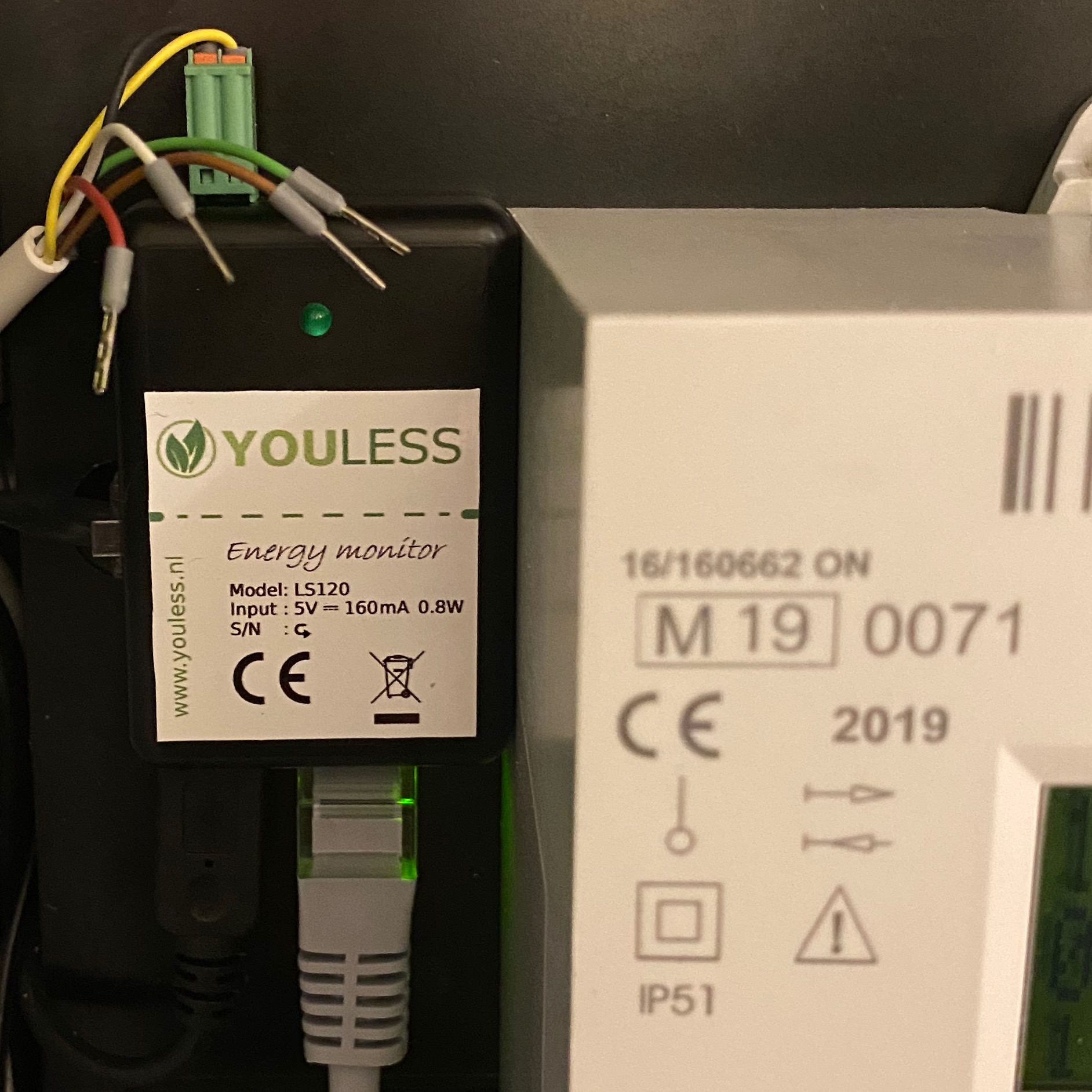

The installation of the puls sensor is very simple. Mount the yellow wire to the S0 + and the Black wire to the S0 - of the LS120.
Mount the sensor on your watermeter (see instructions of the water sensor).
After you have connected the water sensor to S0 and the Smart Meter to P1, it’s time to connect the Youless to your LAN network and power it on with the usb power supply. When connected you can access Youless via the IP adders of your browser. If you do not know the ip, please use a LAN scanner or try: http://youless
Do not change the numbers for Pulsen/kWh and S0 (imp./kWh). On the Youless portal the units can not be changed. In Homey it has the correct unit: m3 for water.
