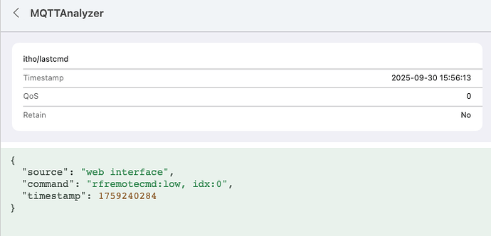

Hello Peter,
Unfortunately it does not work. It is broadcasting (MQTT) but no result.
From the nrgwatch webinterface it is working. I can see the itho/lastcmd
I also tried vremotecmd, because that’s in the Web Api
I have send a message to @ObelixNL . I think (and hope) his App solution will make this work.
Thanks for the support!

Can you show me the MQTT Explorer topics?
I was ‘hoping’ rfremotecmd was a topic, next to, or instead of, cmd topic:
I’m unfamiliar with MQTT Analyser, but rfremotecmd doesn’t seem to be part of the standard topics, because it hasn’t a blue dot on the top screen, and no dot at all at the bottom screen.
