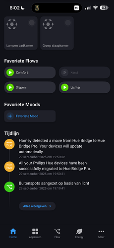

After seeing the updated app on the Homey Pro, I installed the Hue Pro Bridge and migrated all devices in the Hue app. Following the migration, Homey detected the new bridge and transferred all devices seamlessly. Very happy with the result!
Did you had to add the new Bridge Pro as a new device? @Niels_de_Jong

No, I didn’t have to do anything in Homey. If you don’t see a message in the timeline that it has been updated automatically, just restart the Hue app in Homey and it will work.
I can confirm it works. Just upgraded to the hue pro bridge and homey did the rest. I needed to reboot couple of times to make the senors and switches work and needed to repair some groups but it didn’t took me long. Nice job!
