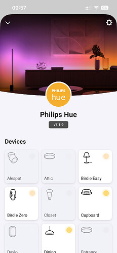

Hi everyone,
I hope someone can help me with the Hue Bridge Pro upgrade:
I waited to get it and do the upgrade until it was officially supported but something is not working for me.
I approximately followed @oklie steps, but I didn’t turn off the Hue app from Homey during the upgrade, also because from @Niels_de_Jong or @Leen_Struuk posts, Homey seemed to take care of the whole migration by itself.
At the moment all my hue lights have the red alert icon, and of course, they don’t work. I did disable and restart the Hue app as well as Homey itself a couple of times but with no success.
A few notes:
  • When I restart the app, the lights show the correct status for a few seconds, then immediately turn to “not available” (screenshots attached)
  • Tapping on any light gives the error: “Authentication Token Expired”
  • I am running an Homey from 2019, Hue App is 7.1.9
I can reinstall everything from scratch if needed, but I’d really appreciate any tips on fixing this without the need of starting over.
Thanks in advance for any help.
Ale

Auth token expired means something like you’d register or log in again;
Longpress one of the red triangle Hue devices, tap Advanced > tap Try to repair
Hey @Peter_Kawa thank you for your message.
I did try something on that line but with no success (Got a different error that I can’t recall now).
In the end I went for reinstalling the whole thing. It wasn’t too bad after all. Only a little bit annoying to fix all the flows.
