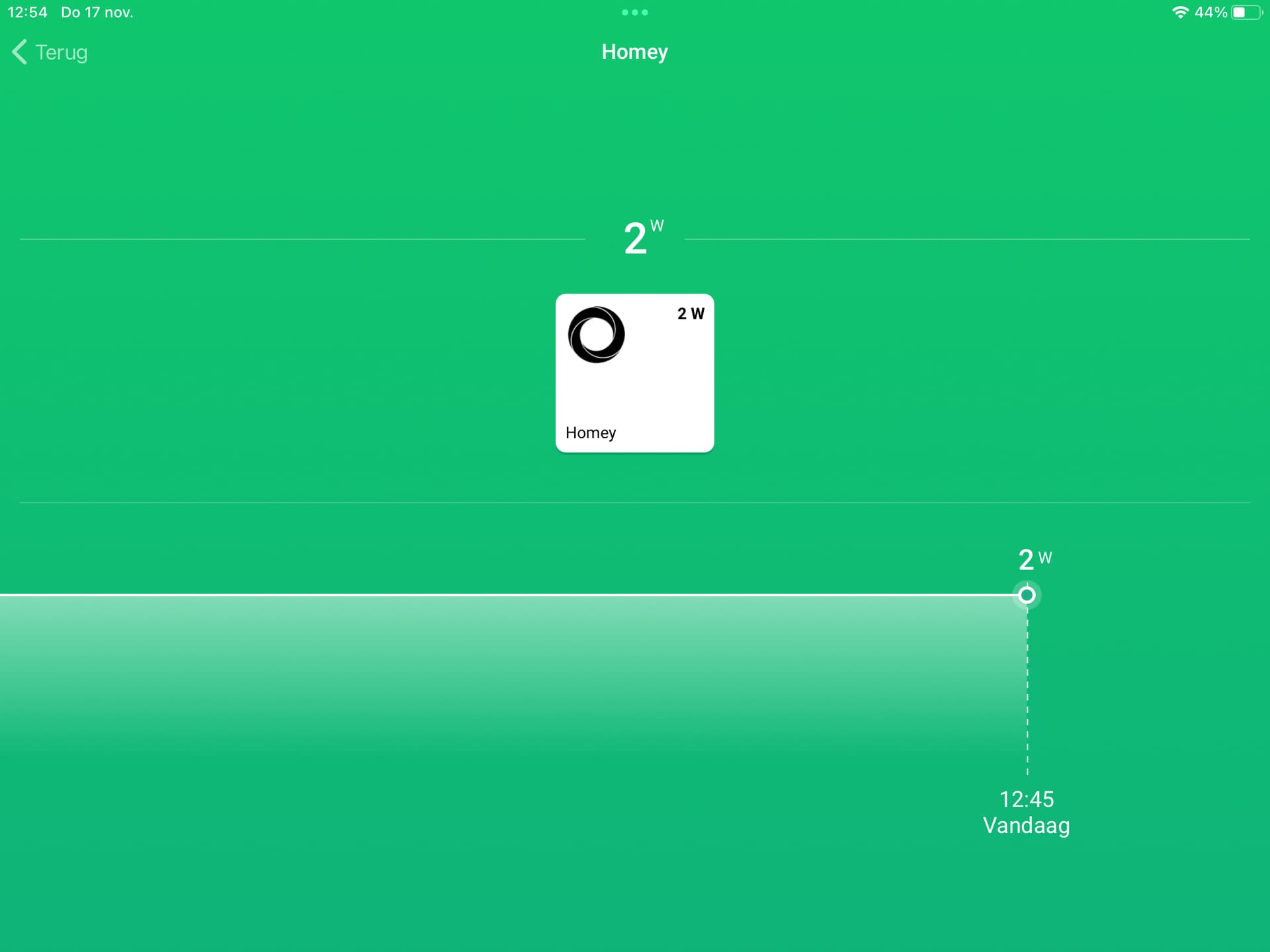

Homey early 2018
Homey Pro 2023 is completely different from any old Homey Pro, so comparing that is like comparing apples to pears.
