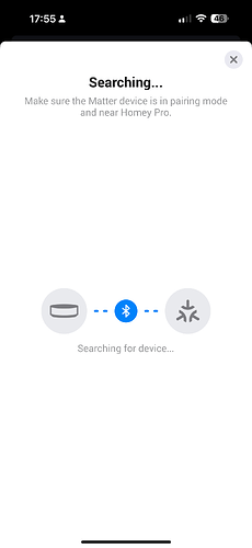

Trying to connect the Tado X smart thermostat without the Tado bridge. So connected through Matter directly to Homey.
Distance between thermostat and Homey is less than 5 meters in the same room
However it seems to always timeout in the Bluetooth connection screen. Same when using the through iOS feature.
Any idea what could be wrong? Already tried factory reset on the thermostat as well as unplugging Homey for 10 minutes.
Homey’s Bluetooth range is bad, try moving it (much) closer than 5 meters.
Pairing through iOS only works if you already have a non-Homey Thread network.
Just tried multiple time next to each other, both through matter with the Tado app on Homey as well as the native matter app.
Still no success :confused:.
Not sure why but on factory reset attempt 1000 it worked :man_shrugging:.
