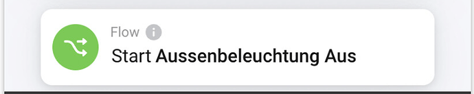

Your “start flow” will ignore (overwrite) the time of your second flow, so it will immediately turn off the lights again.

remove
from the first flow, it starts the flow that switches the light immediately off

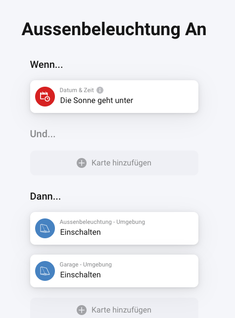

Understood, however I get the light turn on. That’s seems to work also the flow turning the light off. But I want the light turn on at Sun Set and turn off ad midnight 23:59. How can I combined that.
So maybe you want
You need a trigger to start a flow. In your first flow the trigger is “Aussenbeleuchtung angeschaltet”.
So your first flow work like this:
When you switch on the “Aussenbeleuchtung - Zuhause” and it’s after sunset, then switch on “Aussenbeleuchtung/Garage - Umgebung”.
But what you want is, what @Dijker posted:
When the sun sets, then turn on the lights.
