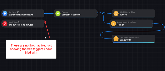

I really hope this is a silly question and someone will point out what i am doing wrong !
I have tried with both the built in Date & Time function and after some research the Sun Events app but i cannot get the flow to work properly
Below is my flow, i am just wanting the light to turn on 45 mins before sunset happens.
No matter how i do this the light never turns on and i cannot figure out why.
Thanks in advance!!

You need to insert -45 in the Sun Events Flow card, not 45.

Put a timeline notification behind the trigger and the AND. Maybe it goes wrong on ‘Someone is at home’ ?
And, always add a notification card right after the trigger(s), to find out if the trigger actually fails, or other parts of your flow fail, or just don’t act as expected.

To test a faillure I put one behind each card in the flow.
Thanks everyone yes i did add a notification after i posted that screen shot so i could verify,
I will add the -45 today and see what happens tonight !

Thanks Everyone using the -45 has fixed the issue!
Really appreciate the guidance, and again sorry for the basic question
