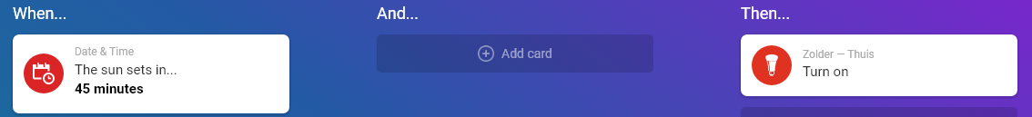

I’d like to crete a flow that says something like
When - “45 minutes before sunset”
Action - “Turn on that light”.
Is this possible?

sunset-45
This should work, methinks…
And also with the build in time cards:

Is that to be read as, when it is 45 minutes to sunset?
I thought it meant, when the sun sets, wait 45 minutes?

That will be correct. And this card is not from an app u have to download, it’s a standard card already build in .
