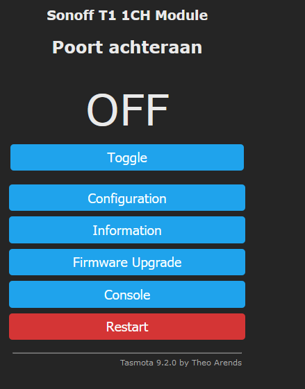

i soldered the 4 cables to flash tasmota on it.
(photo from the internet)
i selected a useful profile ( i think Basic would do for the most of us.)
afbeelding
and added this to Homey with Sonoff app from @robertklep it works like a charm!
