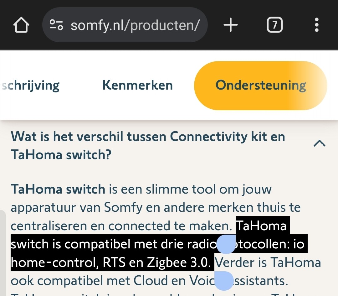

I thought that is for Somfy IO, not RTS.
You are doubting Adrian ‘Mr. Somfy’ Rockall himself :sweat_smile:
(Sorry, couldn’t get English specs, but it says: “Tahoma and Connectivity Box both support io as well as RTS, and Tahoma also Zigbee 3.0)”
Tahoma definitely works with RTS TaHoma RTS Gateway | Smart Control For Your Somfy Shades
