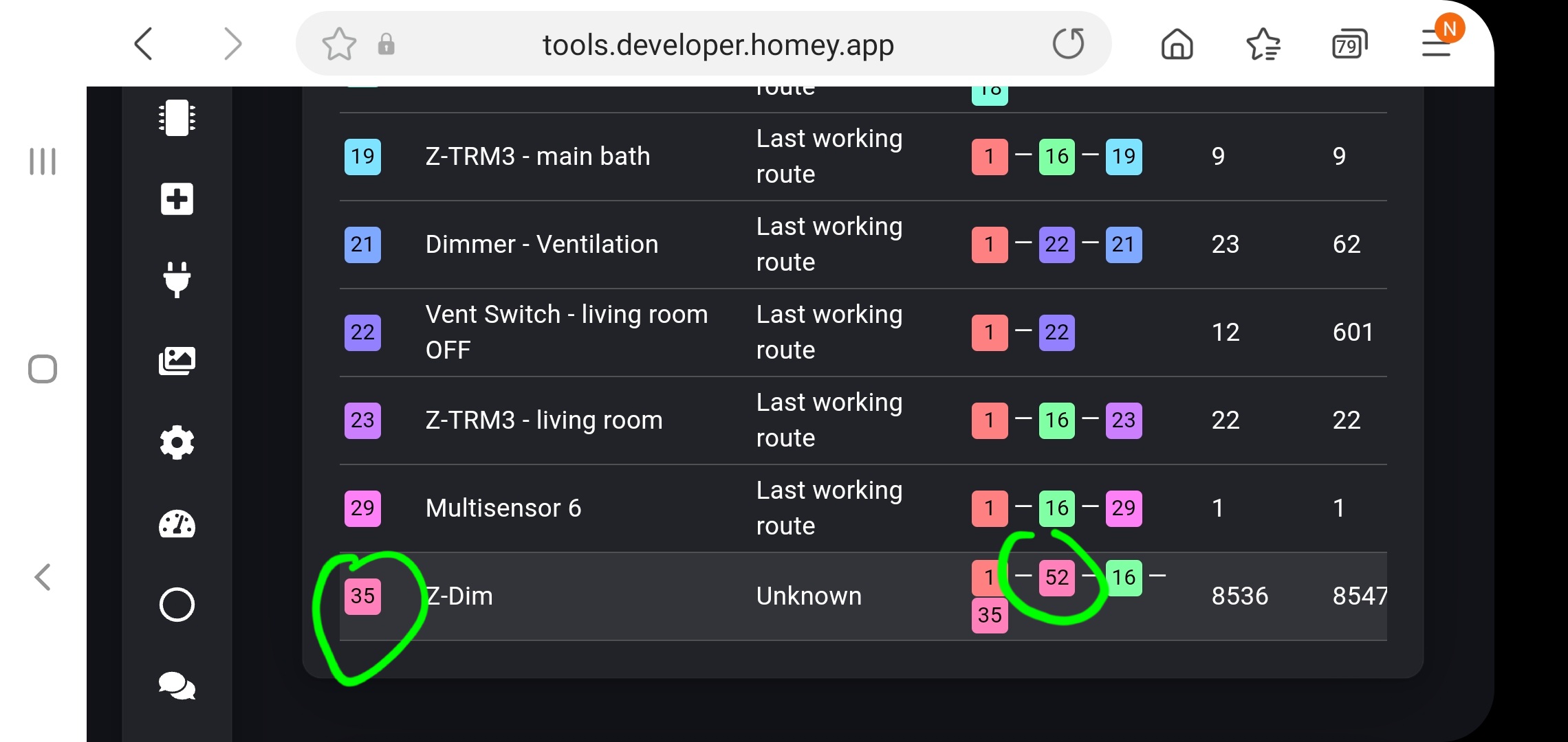

But first of all the numbers appearing in the route are out of range of numbers and different every time. My newest device has ID 35 but routes include higher numbers.

Every 3 days I get it on the last added device Heatit Z-dim. But it might be also because it is the last one.
This device is very close to the homey hub and surrounded by other z-wave sensors. Using any device between the hub and this z-dim really does not make sense. Dream about the feature to lock the route and prevent re-meshing.

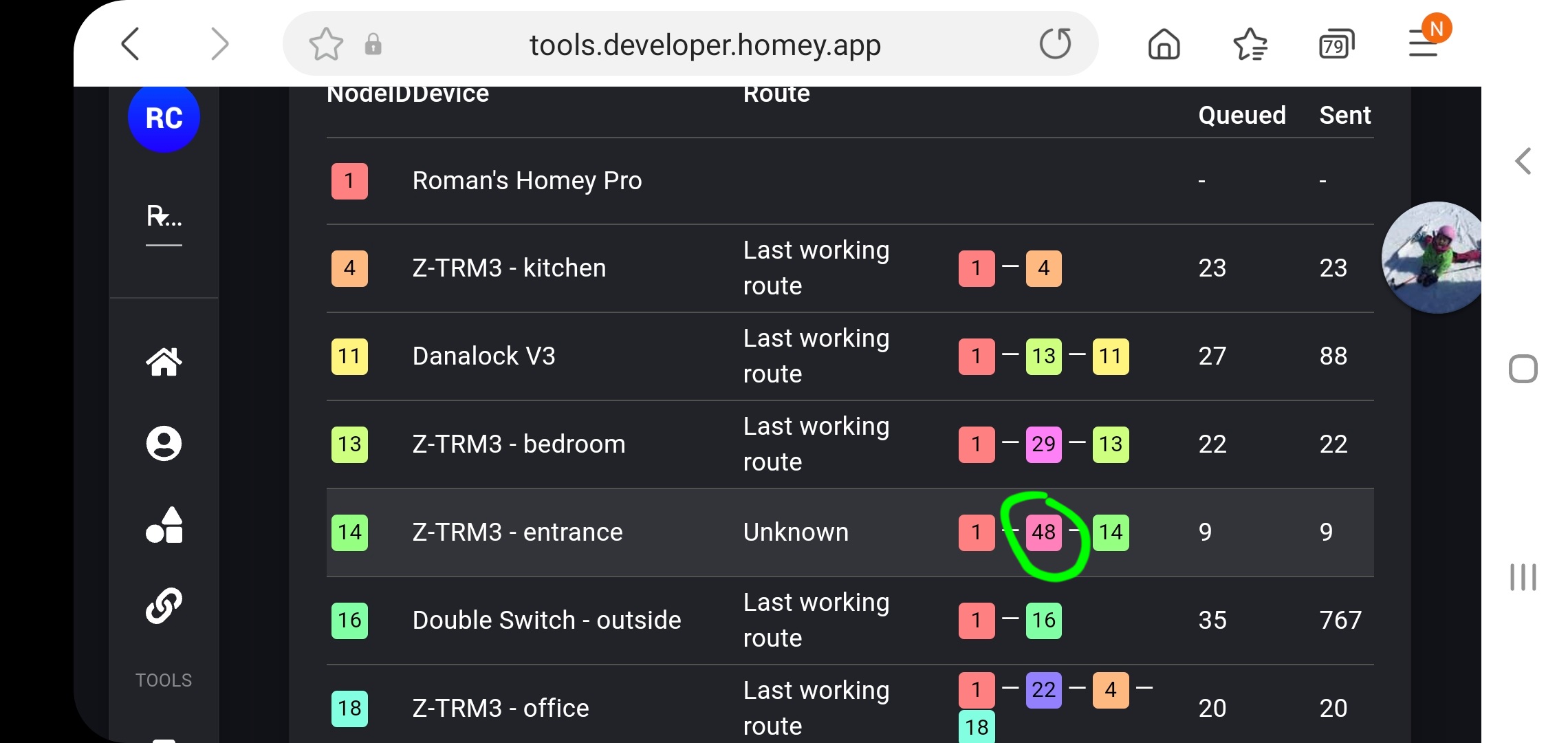

I have checked and see now that I have another device in the top part of the list with the wrong/unexisting numbers in the route. But this one was disconnected for a while (phisically powered off from electricity).

I myself disconnected a router from the power supply several weeks ago, it’s flagged as “Unknown” route. Nevertheless, no device is routed via a non-existing NodeID or via a non-existing device. Nevertheless, no device is routed via a non-existing NodeID or via a non-existing device as it’s the case with you.

But my one Z-Trm3 received a strange roure being OFF the power. As I remember is was always working well before switching off.
How did it get the unexisting NodeID and when I do not know.
So I have 2 devices with unexisting routes.

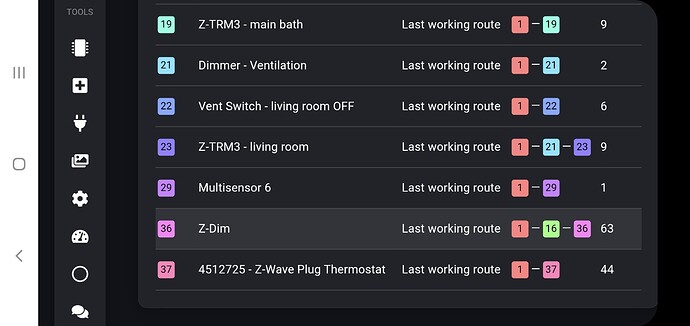

Removed and paired again the problematic dimmer. It was a strange experience. To unpair I clicked 6 times the button expecting no reaction as usually but this time the app said that I am trying to unpair another device not the one selected. I have only one dimmer and it was definitely correct one. So definitely homey could detect that I was clicking this dimmer. It was probably in pairing mode.
The new node Id is 36.
Added one more z-wave socket with the number 37.
Restored flows. Waiting for disappearing a device.

The fake NodeID is 116. Compketelly out of any ranges.
