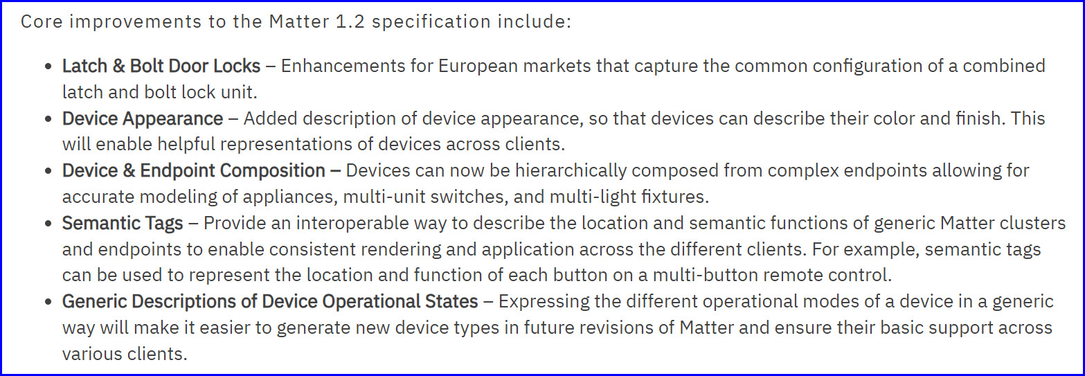

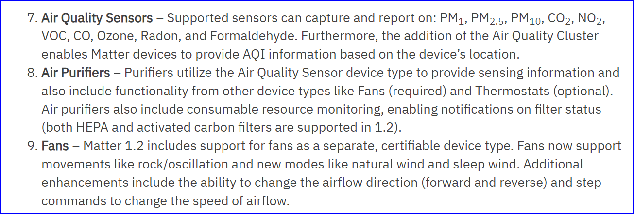

CSA - Connectivity Standards Alliance - Matter 1.2
Home Security - Video Cameras - NOT included in Matter 1.2
The 9 x NEW Device Types - In Matter 1.2
