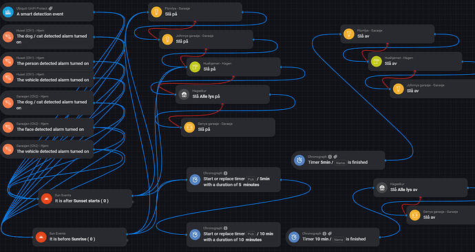

Hi, I do not have RCL-410 but CX410.
But yes, it recevies notifications and triggers the flows.
I use it for controlling outside lighting.
