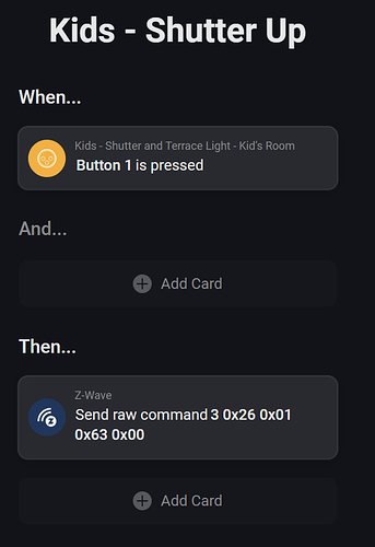

This is exactly my problem too except I use a Senic Friends of Hue switch added as a Hue Tap Button. I’m completely new to Homey and not a programmer. Can you please explain to me what should I do with these codes to make mine work as well?
0x26 0x01 0x63 0x00 => UP
0x26 0x01 0x00 0x00 => DOWN
0x26 0x05 => STOP
Currently 1 have one button assigned to “set the position to 0” and an another button to “set the position to 100”, so I can send the shutters up or down completely, but nothing in between as I can’t make the blinds stop for the push of button.
Any help would be kindness on this topik.
You mentioned „hue“ which is zigbee, not z-wave. I don‘t know if/how this works for zigbee devices.
For z-wave these would be the steps….
You just need to create a new flow for each of these codes to send them to the Z-Wave device.
Navigate to
New Flow / Z-Wave / Send Raw Command.
Enter the Node ID of the Z-Wave device and drop one of the codes (e. g. „ 0x26 0x01 0x63 0x00“) into the parameters field.
The Node ID can be found here
Let me know if you need further information.

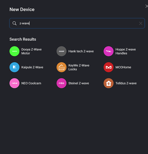

Hi,The “Hue device” (Senic switch to be exact.) is only a button interface to operate the shutters.
In terms of the zwave flows. I get stuck right at the beginning.
If I hit the new flow button, I only have 2 options:
Standard or Advanced.
And when I choose standard, I have no z-wave option at the then cards:
also when I search for z-wave at new devices I don’t have a raw option:
Can you please align me into the right direction. Thanks a lot.
Ok I found it, I had to enable the experiment mode to get the raw zwave flow. Appreciated this tip.

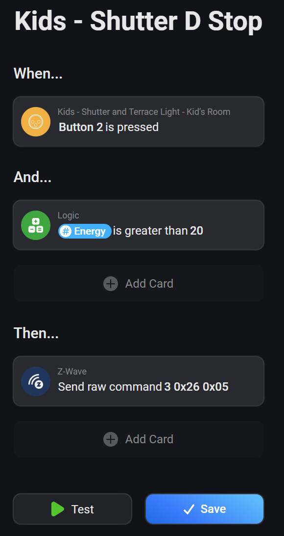

What was the when - then logic for your stop action?
For the going up I am just setting it up:
I assume this will be the same for going down.
But how did you approach the stop state from flow and logic wise?
Thanks in advance
Unfortunately there is no „is stopped“ property you could use with Qubinos. But you can use the current power consumption to judge whether the roller shutter is moving or not. If you are using a up/down switch, you simply have read the power consumption. If it is below a certain level, then hitting the up button sends the „up“-command. Else (= power consumption is above the threshold), you send the „Stop“-commend.

Unfortunately the codes provided in this thread does not trigger the blinds for me.
These are my setups:
Shutter stop:
Did I set them up correctly?
