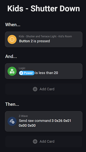

I have changed the flows this way as you suggested:
When I do the test of the up or down flow i get a green checkmark for the conditions, but the shutter doesn’t start moving.
I tried both options on off “for invert shutter movement direction”, still nothing is happening

Don’t see comma’s between the parts of the RAW commands.
https://homey.app/f/_CkBhB
@JPe4619 : Eagle Eye! That‘s most likely the issue!
This is the content of my „up“-Flow:
0x26, 0x01, 0x63, 0x00
……including commas.
Thank you guys so much for helping me out. You rock! Now the blinds started to move. Yay. Mini win. Now I just have to figure out the anomaly that sometimes they react to the push of the button, sometimes they don’t.
