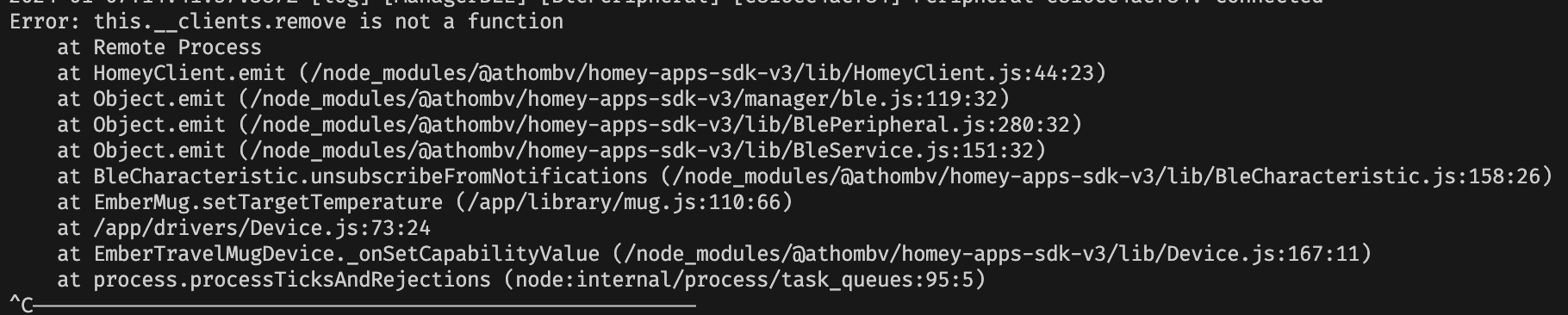

I have the same problem (using Homey 2023) when creating Ember mug app, I can connect Mugs and until Mug is online and not discharged I can connect, but once I power off mug and restore power Homey can’t connect to mug, but when making same actions on iOS with power off all works great! It feels like Homey doesn’t remember the connection and just drop it with disconnect.
Also I found that “unsubscribeFromNotifications” not work at all, even in Web. It always drop this error:
