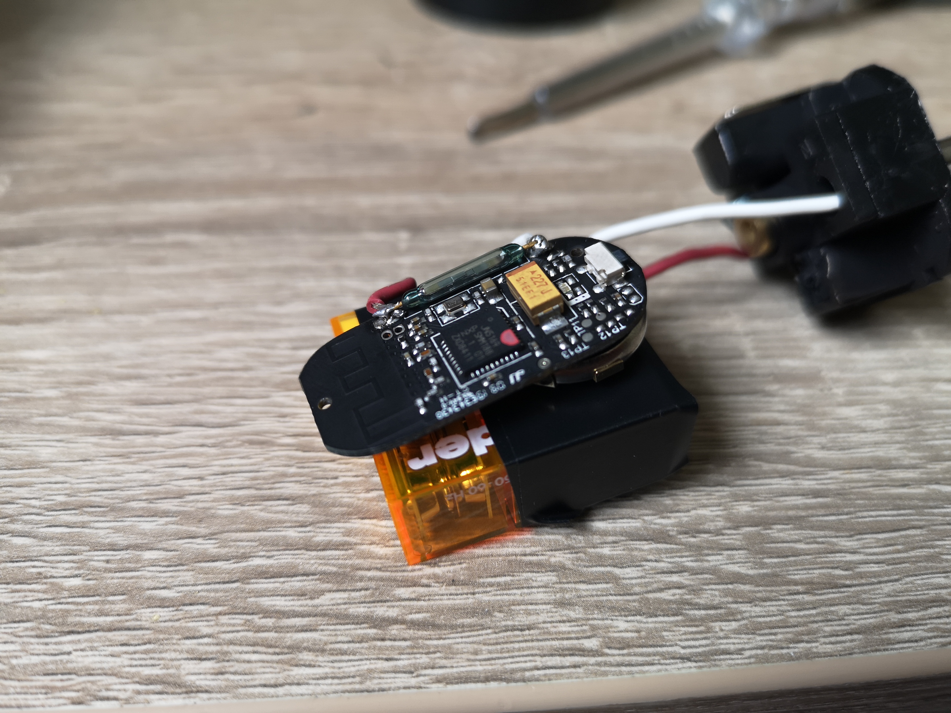

I was playing with cheap Aqara door sensor yesterday and realized that it can be easily used for this purpose in combination with with 230V relay like this one (230V relay).
You need to disassemble Aqara sensor and solder wires to magnetic contact detector - its easily accessible. Than connect it to relay and power the relay coil by 230V. In case of outage, relay will change its position and aqara will send command to Homey. Rest of the flows is obvious :slight_smile:

This is how it looks like. Relay and door sensor fit inside the socket.

It’s a very interesting solution, I have a spare door sensor (SonOFF) and I think I have found the same relay you are using (Finder 40.61.8.024.0000) can you share the pinout connections please?
Thank you
Here you go with pictures.
Thank you very much! I’ll try to do it myself tomorrow! it’s a very clever idea!
If I’m reading the datasheet correctly, that’s a 24V relay. You want a 240V relay, number 40.61.8.240.0000
Thank you for pointing it out!!! I was in rush to find a suitable relay on Amazon with delivery for tomorrow and I misread the numbers!! Ordered the 240V version now!
Oh well, the only one available is a 40.52.8.240.0000 but from the datasheet the only difference is 2 CO 8A instead of 1 CO 16 A, the connections should be the same I think…
