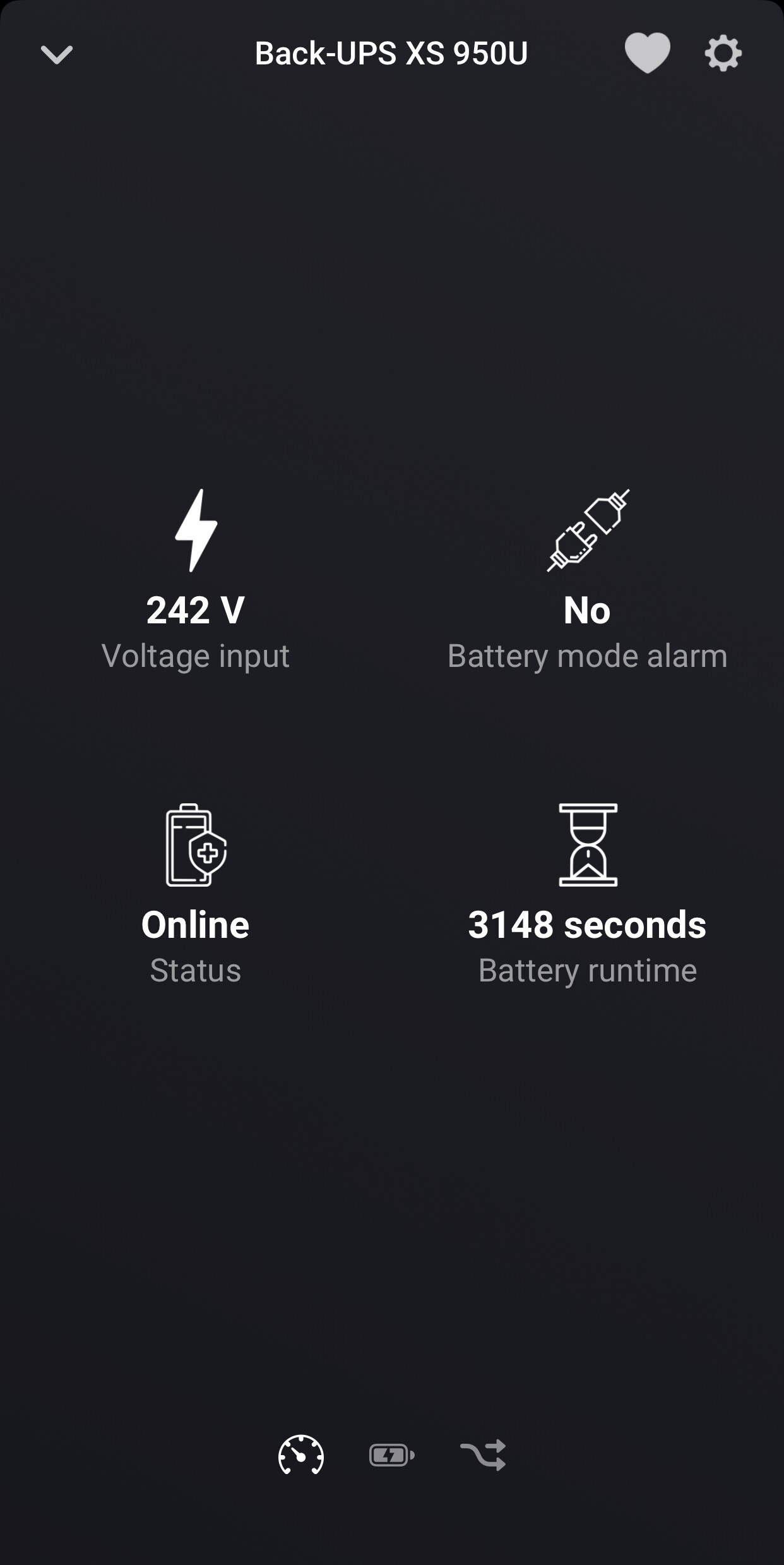

If you have the UPS connected to synology you can add it in homey with Network UPS Tools app.
After that you can get any data from it.

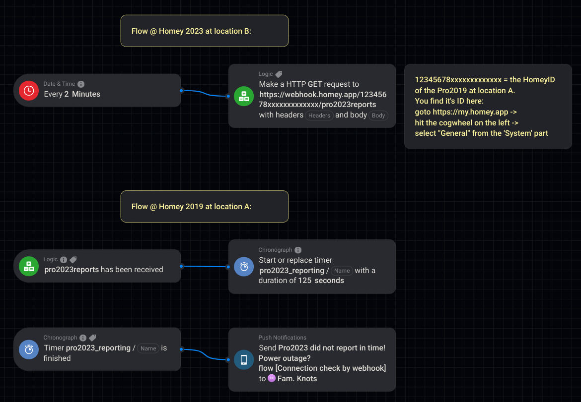

I have a slightly different setup: I have two buildings, building A and B. These are in different locations and A has a Homey Pro 2019 and a Synology NAS. B is in an area with frequent outages and has a Homey Pro 2023.
My question: Are there any easy way for me to poll from one to the other if there is an power outage?
With the NetScan app you can poll local and or internet connections
So when you use VPN: just poll the other Homey’s IP.
I know it is a connection probe, but when power fails, connection also fails most probably.
Also, Pro 23 at location B can send a webhook every x minutes.
It should ‘start & replace’ a timer with a runtime slightly longer than the webhook interval.
When a webhook is not sent/received at the interval time, there could be a power outage; now the timer finishes and can send an alert or the like

I made example flows from what I described with the webhook via internet.
The timer should not finish before 120s (the webhook send interval), so let’s set the duration to 125s.
This way it takes max. 125s to get a warning when no webhooks are received anylonger.
When time is critical, try to set the webhook sending flow trigger at ‘every 1 minute’, and set the timer duration to 65s.
The logics trigger card is called When “[event] has been received”.

I set this up on both sites and for some minutes it worked. My implementation on the pro23 side:
Exactly the same but opposite on the pro19 side. I booted the pro23 to fake an outage and received the “Not received…” message from BOTH Homeys!!?

Yepp. Taken your advice and am monitoring the one with most outages first. It works fine. Thank you again!
It isn’t but after 30 min it was up again. Strange but Yippi! Am gonna take your advice on this on both Homeys and add smart sockets for remote restarts.
Am happy with current implementation and am gonna gradually implement the next, then both at the end…
