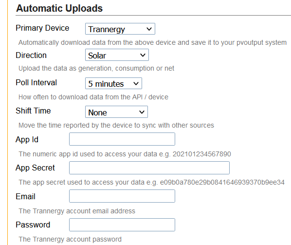

Is there any way to find the/an API? I converted from Trannergy app to Solarman app, but my API (which I created at pvoutput.org) is not working anymore.
I created the following issue. Solarman doesn't report production anymore · Issue #166 · DiedB/Homey-SolarPanels · GitHub
Unfortunately they aren’t responding.
It took a while but I found out a solution for this… (trannergy and pvoutput)
Just make sure you get the API ID and key and then follow the instructions. It worked for me.
