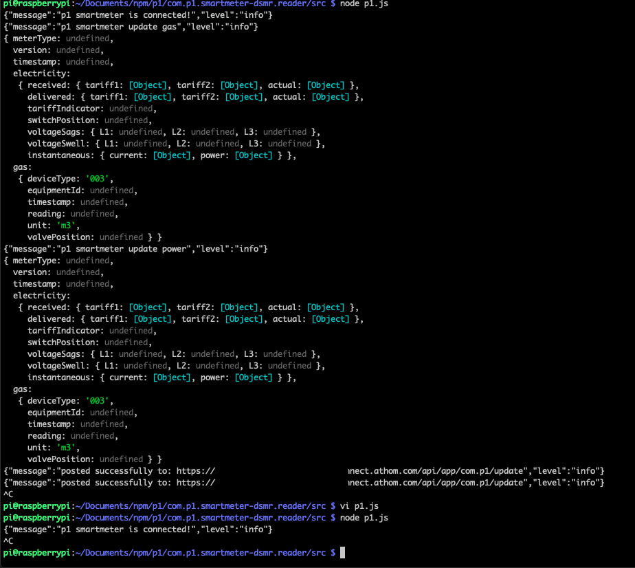

See the screenshot below.

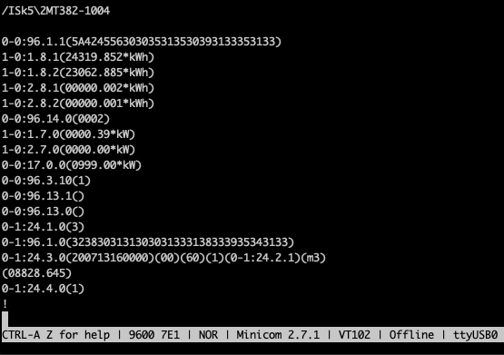

The top output is with the 9600 7 none settings the bottom one is with 9600 7 even which should be the correct settings.
The strange thing is that with the correct serial settings its not getting any data. Even though when using minicom the correct data is received.
@robertklep
See hereby the outcome when using minicom with the correct 9600 7 even settings:
Screenshot 2020-07-13 at 16.05.13
This suggest me that the data from the reader is correct.
It looks like the script can’t parse the output of your meter. I have the same meter, so I know it’s DSMR 2.2. When I use the parser from node-dsmr, it can parse the telegrams just fine, so it’s not that.
However, I just noticed that the p1.js script will post incomplete data to Homey, which is why it looks like it’s working, but it probably isn’t.
Can you also add this after this line:
console.log(telegram)
That should show that the script has actually read from the P1 port.
Nothing seems to happen when adding the line.
Screenshot 2020-07-13 at 16.13.15
Screenshot 2020-07-13 at 16.13.26
That doesn’t make sense, because then it would never reach the “posted successfully to” lines that were being logged.
By the way, what type of reader are you using for the P1 port?
Strange isn’t it. I can’t make any sense of it and with the wrong serial settings it is posting data even tough its incomplete.

When adding the console.log(telegram) this is the output:
Yeah, it may say it posted successfully, but in fact it posted empty data because that’s what the parser returns. I think you need to fiddle with the serial configuration and hope there’s some magic combination that works (I use 9600 baud, 7 bits even, 1 stop bit, but I’m using a software serial library on an ESP8266, not a dedicated p1-to-serial cable).
