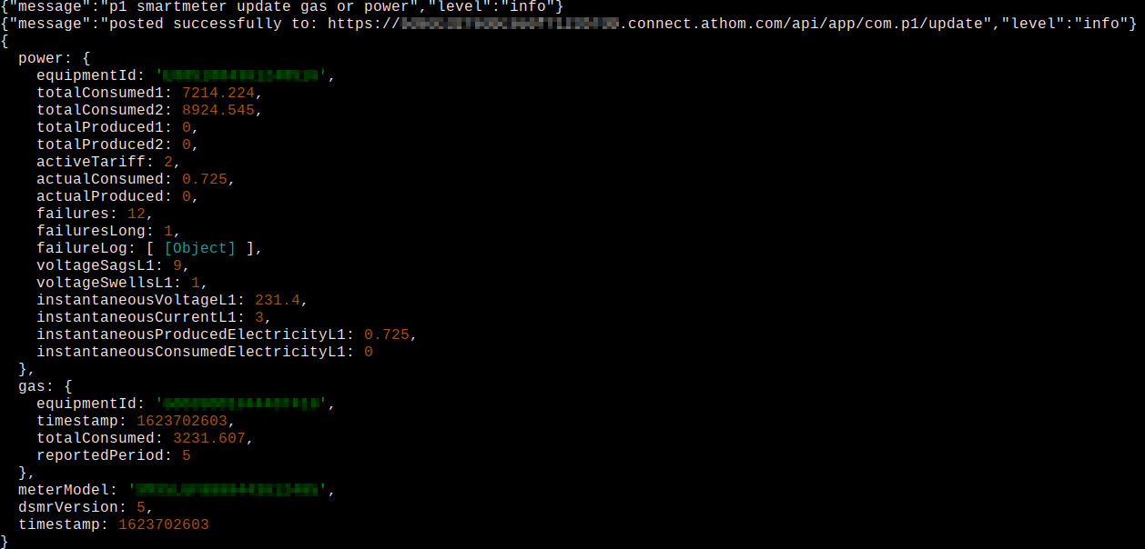

Sames issue persists. Today finally installed the cable on my RPI 4B. All is functioning well except the current power variabele. The data is there, but somehow not imported by the app:
However, the device capabilities in the Developer Tools shows “null”.
No more replies in 2 months on this thread, this cannot or shall not be resolved then (or maybe already is resolved)?
Peter
Question, looks like the values are not shown correct or they are not correctly collected. When I look at the values of “huidig verbruik” and “teruglevering” they should be switched. (see screenshots)
Same goes for the values in the evening, they are negative.
