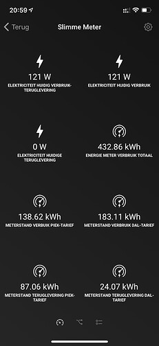

P1 smartmeter (API)
Here is the other screenshot. (not allowed to post than 1 image due to new user status)

What’s invalid from your point of view?
Sure! df3bda2f-a396-41fa-8132-eec8de052fde.
The values “terug levering” and “huidig verbruik” should be switched.
As now my usage in the evening, when the sun is down, is zero. (which is not true)
Yes, they are flipped around. And also weird is that during the day you always seem to use energy (it is not zero), even though you seem to be delivering to the grid most of the time.
Do you have 3-phases maybe?
Or do you live in Belgium? I think the smart meters there report reversed, so that matches your experience with flipped results.
Yeah I have 3 phases. No i live in the Netherlands
Ah, when your usage is on 3 phases but your production is only on one phase, it explains why you still consume power even when your production is way higher.
Weird that your usage and production are switched. Did they give you a Belgian smart meter🤪?
Is this fixable?
To fix it you need a 3 phase inverter that feeds your production to the grid.
Or alternatively change your grid connection to only 1 phase, so you always use from the same phase as the one you are producing into. But if you for some reason need 3 phases that will not be possible (e.g. you have a 3 phase car charger, or high power demands in house)
