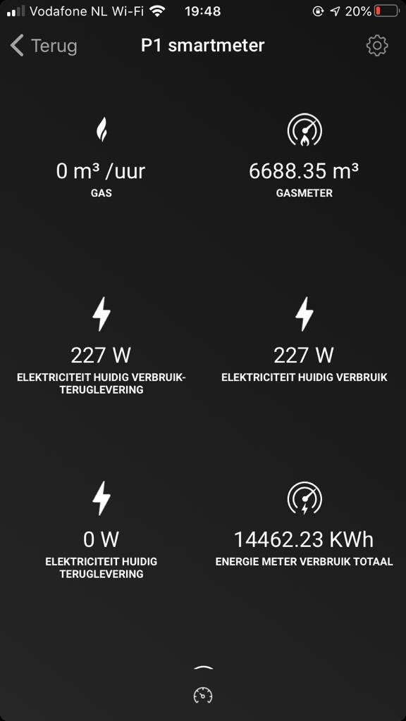

No, it never worked, only a dash sign. See the screenshot i made.
I have the same (similar?) problem, using V3.1.2 I don’t see the current use for electricity, same for V3.1.4
If I also install the “Slimme meter (verouderd)” device when using the 3.1.2 app, that does show the current use so I am guessing that the script is at least sending out the data but not correctly for the new device in Homey?
The ‘Slimme meter (verouderd)’ isn’t supported anymore. There is one capability: ‘elektriciteit huidige verbruik/teruglevering’ that is used.
You have to add the new device

You are not sending readings.
   "electricity":{
      "received":{
         "tariff1":{
            "reading": 1  // <-- you miss this
            "unit":"kWh"
I think you are not getting the good values from the p1 meter or they cannot be parsed by the node-dsmr parser.
I’m facing the same issue and have similar values as @VvBemmel and started debugging.
It seems like this is because the “reading” key does not exist for L2 and L3 in the keys “data.electricity.instantaneous.positive” and “data.electricity.instantaneous.negative”. These keys return “undefined” which makes the calculate result in NaN and breaks the values of the device.
I’ve commented out the following part in :
let measurePowerConsumed = device.round(
(data.electricity.instantaneous.power.positive.L1.reading +
data.electricity.instantaneous.power.positive.L2.reading +
data.electricity.instantaneous.power.positive.L3.reading) * 1000)
let lastMeasurePowerProduced = device.round(
(data.electricity.instantaneous.power.negative.L1.reading +
data.electricity.instantaneous.power.negative.L2.reading +
data.electricity.instantaneous.power.negative.L3.reading) * 1000)
and replaced it with:
let measurePowerConsumed = device.round(data.electricity.instantaneous.power.positive.L1.reading * 1000)
let lastMeasurePowerProduced = device.round(data.electricity.instantaneous.power.negative.L1.reading * 1000)
This gives me some results:
However when i produce less power than i use, it does not show me how much i’m producing.
Does this still sound like a node-dsmr parser issue to you @Koktail? if so i will dive a layer deeper :slight_smile:
The app is designed that it gets that reading with a numeric value. (If the P1 doesn’t support it use the reading: 0).
