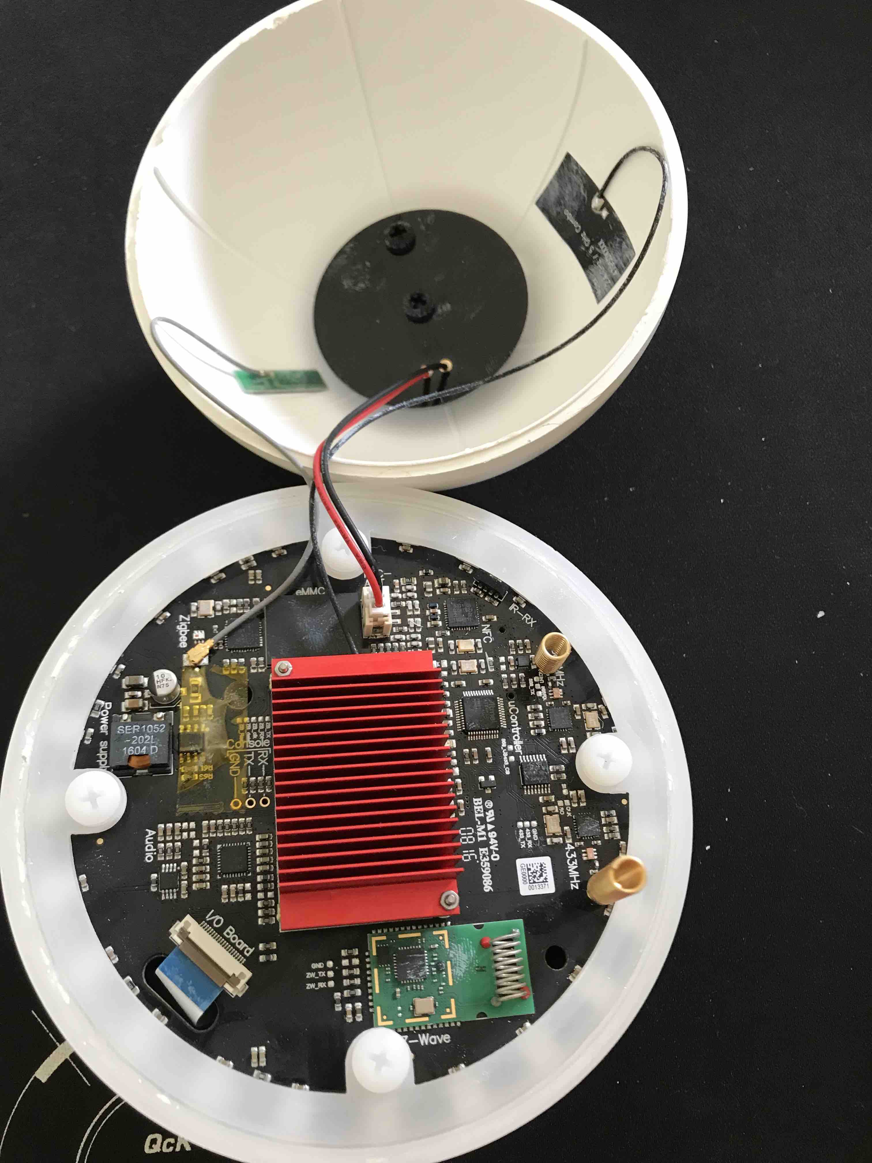

Looking at the PCB there’s a fuse in the power supply area and also what looks to be a switching power supply IC. I would start checking those.
Robert thank you - do you mean those two parts?

Yes, those are the ones.
It’s quite possible that this is a 3.3V power supply (which could have survived a higher voltage) but that other parts of Homey are directly powered by the USB power supply and got blown up. Worse case, the SoM module is dead :grimacing:
That’s what I suspect as well… it’s a pity there isn’t any carrier board for that module
It’s a carrier board in itself, see this page for the single core/512MB module and this page for the dual core/1GB module. You can see it has three connectors that I assume connect to the main Homey PCB.

Soo the same thing happened to me, cracking noises, led flashes red, disconnected power only a single blue light comes on.
Opened homey, and i find a fried component, problem is I don’t know what it is.
Anyone knows what this is by any
chance?
Thank you
Found some pics, but the chip doesn’t seem to be marked.
I’m fairly sure it’s an Analog Devices SSM2305 “Filterless, High Efficiency, Mono 2.8 W, Class-D Audio Amplifier”.
