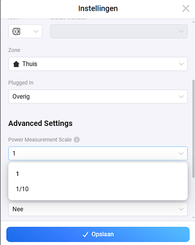

Echter gekeken naar jouw advanced Settings zie ik iets heel anders dan een code.

Wil je de Woox opnieuw toevoegen, maar dan als “ander” apparaat?
Bij een herkend/bekend apparaat wordt de code nl. niet getoont zoals je hebt ontdekt.
Peter, Inderdaad nu wel code’s.
{ "device": { "active_time": 1722601738, "biz_type": 0, "category": "cz", "create_time": 1607625713, "icon": "smart/icon/ay1533895021982bN2sO/5d3d8b811dfafaf5071f94d88750e83d.png", "id": "150760655002911403cf", "ip": "<redacted>", "lat": "<redacted>", "local_key": "<redacted>", "lon": "<redacted>", "model": "R6080", "name": "3", "online": true, "owner_id": "<redacted>", "product_id": "dmurhme5sc89cxfd", "product_name": "Smart Plug", "status": [ { "code": "switch_1", "value": true }, { "code": "countdown_1", "value": 0 } ], "sub": false, "time_zone": "+01:00", "uid": "<redacted>", "update_time": 1722601741, "uuid": "<redacted>" }, "specifications": { "category": "cz", "functions": [ { "code": "switch_1", "desc": "{}", "name": "开关1", "type": "Boolean", "values": "{}" }, { "code": "countdown_1", "desc": "{\"unit\":\"s\",\"min\":0,\"max\":86400,\"scale\":0,\"step\":1}", "name": "开关1倒计时", "type": "Integer", "values": "{\"unit\":\"s\",\"min\":0,\"max\":86400,\"scale\":0,\"step\":1}" } ], "status": [ { "code": "switch_1", "name": "开关1", "type": "Boolean", "values": "{}" }, { "code": "countdown_1", "name": "开关1倒计时", "type": "Integer", "values": "{\"unit\":\"s\",\"min\":0,\"max\":86400,\"scale\":0,\"step\":1}" } ] } }
